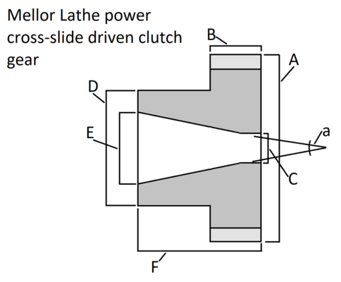

I plan to make replacements. but I've only ever seen the required parts in photos. I have no measurements. So, could I ask any member here with a Mellor, if they'd be kind enough to provide me with the following measurements, please?
A: Gear OD - by calculation based on the driver gear I think this is a 2" OD and 24 teeth (12DP)...?
B: is this the same as the driver gear? 9/16"?
C: central bore - is this 1/2", to be a good fit on the shaft?
D: I assume this dimension is non-critical, but it'd be nice to be as close to original as possible,
E: the largest diameter of the clutch taper
F: the overall length
a: the taper's included angle.
Given these, I think I can infer everything else I'd need to make this part, the matching half of the taper clutch & the star wheel. TBH, I imagine I could just wing it and guess the dimensions and still come up with a functional article, but I'd prefer to make the part as close to original as I can.
