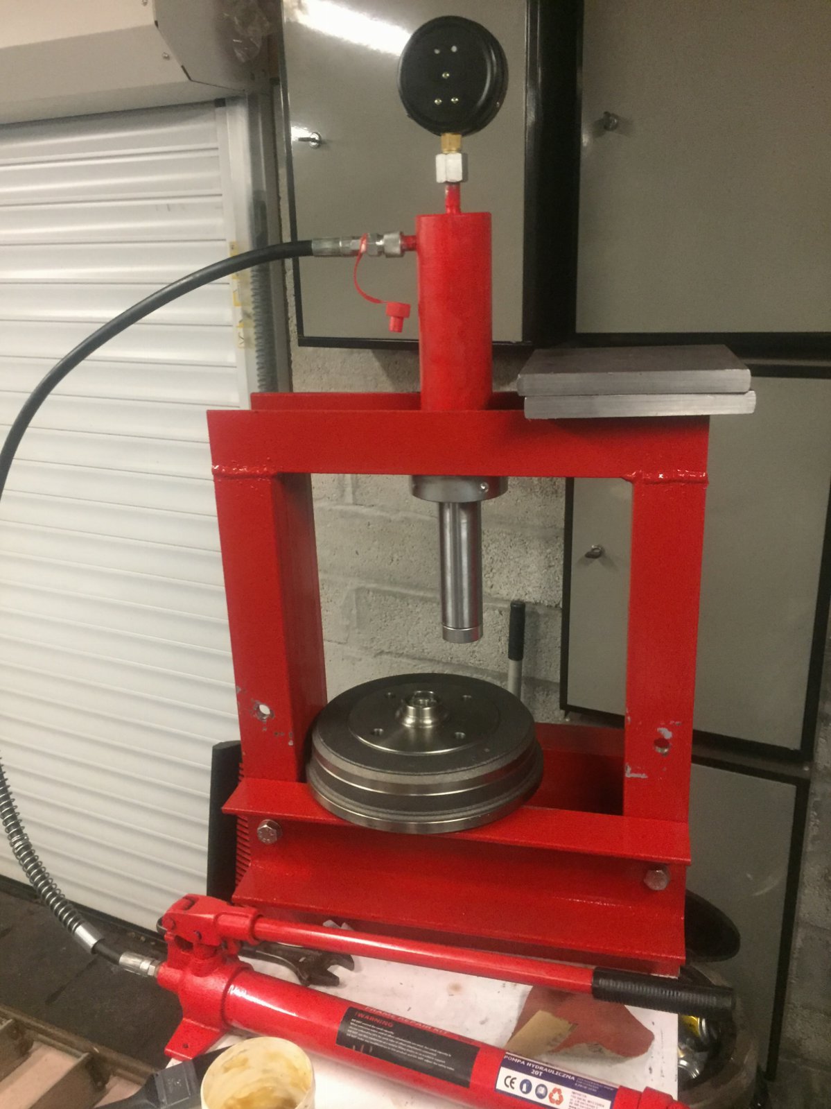

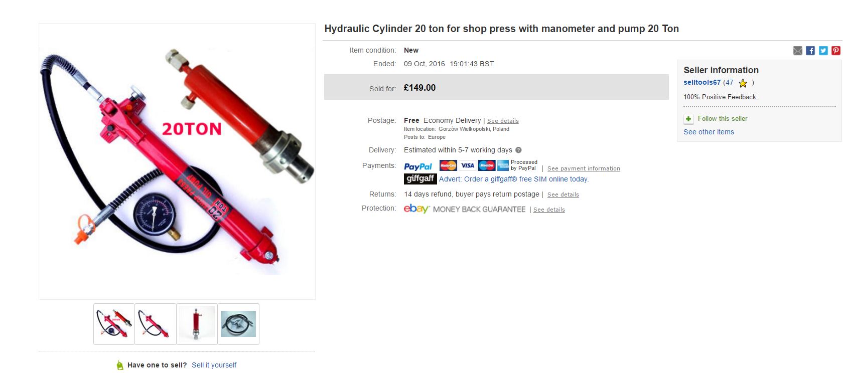

I knocked this together from some C-channel and a hydraulic ram I got off fleabay. I reckon it worked out half the price of a Machine Mart 20-tonne one.
In the picture I'm using it to press in the bearings to some Beetle front drums (one of my current projects).
I decided to go for a 20-tonne cylinder, but at 15-tonne I can see the top channel bending a couple of mm, so I haven't gone beyond that, and will probably never need to.
But at least I know my welding is half-decent, through (thankfully) non-destructive testing. It was migged, about 125 amps I think, never approaching full penetration but I was welding from both sides on every seam so I reckon probably enough penetration. The channel is fairly thick, 15kg/m channel. I actually didn't expect to see any deflection at 20 tonne, but there is some.
I'm planning on welding a couple of tabs on the end of the bench to bolt it to, I don't want it to take up more floor space than is necessary.
