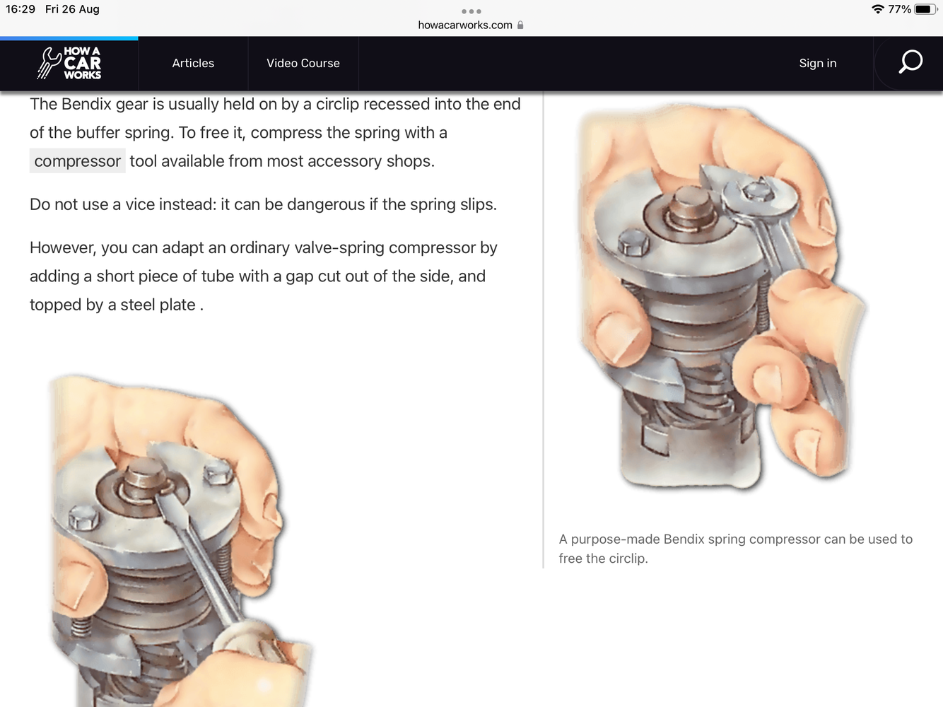

Removing a bendix from a starter motor, it compresses the spring so you can release the circlip
Edit, just added a picture for you

Guess.Come on man, don't be cryptic - a tool or a pic?![]()
No good at night then ?Handy tool in the day
