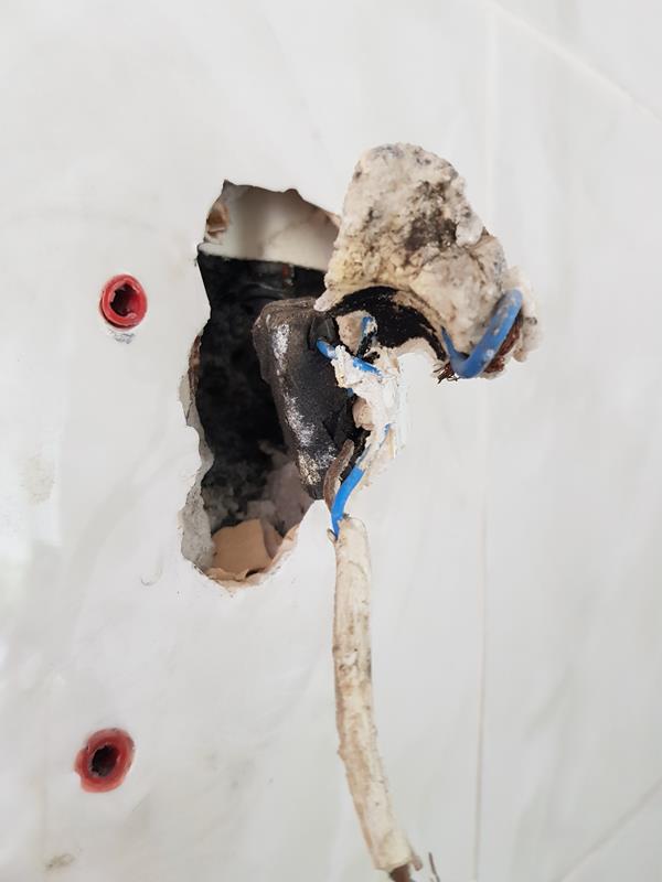

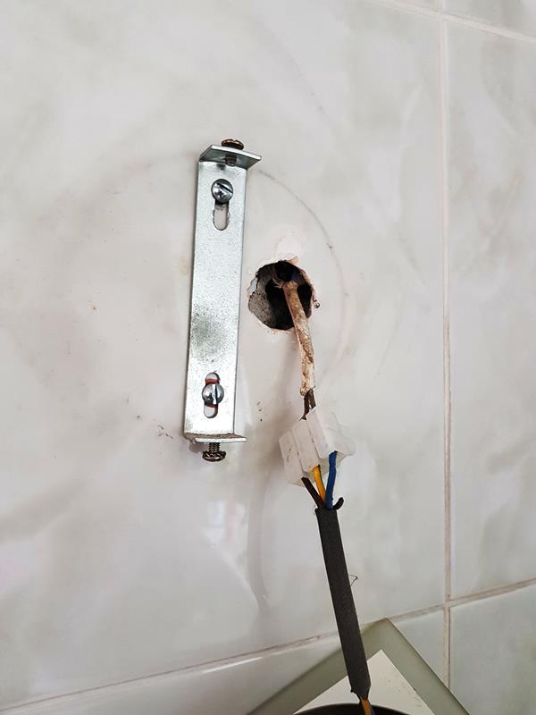

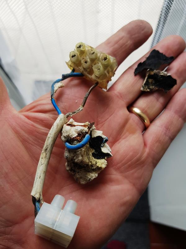

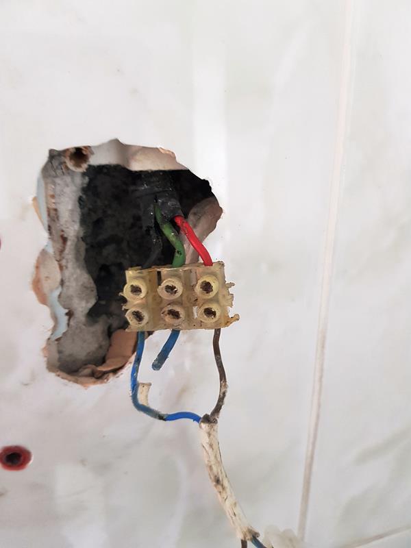

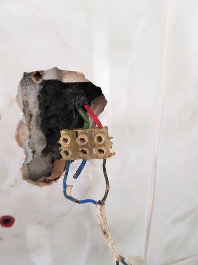

Long story, we bought the house from an elderly couple and it was pretty obvious that they had been taken a lend of with the DIY brigade. This is the very last room to do really but it is the washroom at the back door so we haven't been in that much of a rush. Missus reported a bulb out. I started to investigate, wish I hadn't now as it is going to take a chunk of time and money:
