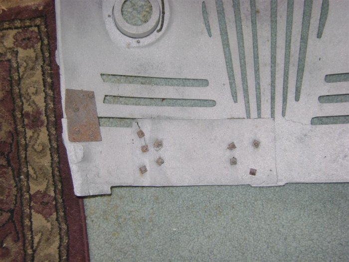

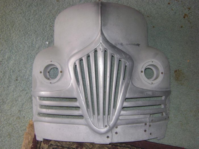

This is a cast alum front grille from a 1940's or so bumper car from an amusement park. It was "fixed" years ago with some screws and sheetmetal. I will remove the sheetmetal and screws, vee everything out, straighten where needed and fill it with my 3035 spoolgun with 4043 wire. The holes will be welded shut and everything sanded flush. But i can't do it today so tomorrow i will have some finished pics...Bob
