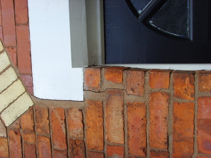

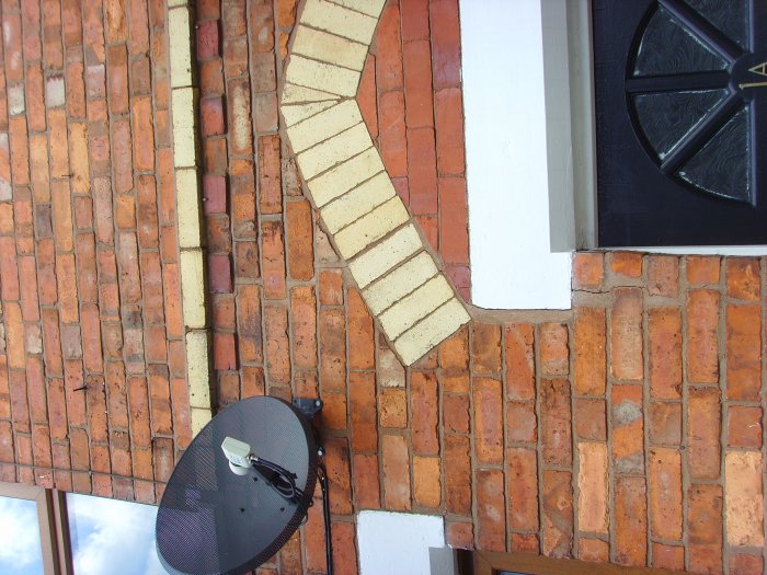

Ok have a look at photos , you can see why the brickwork is cracking . the lintol is bearing on half a brick , Now im thinking of propping up with an acrow , cutting out the half brick and replacing with a full brick . Same on the inside as the crack is internal as well half way up the wall upstairs. Nothing major just a hairline crack in the plaster .
Has anyone got any other advice or knows of a better way to sort it , i 'think' you can get some kind of stainless ties that you
resin in the joins horizontally ???
