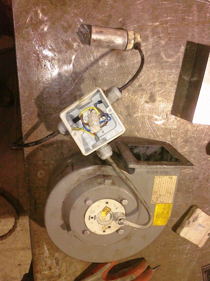

Hi, I need to know if I can run this motor via a dimmer / variable jobber / speed control, and if so, how?
1 phase, 220v, 1.1A, 0.21 kw.
It has a starter capacitor, and the plate says 8 micro F.
Now the interesting bit - it has 4 wires. U1 V1 and W1 (plus earth).
Live goes to U1. Neutral to V1. Capacitor wired between V1 and W1. Plate states swap N between V1 and W1 to reverse direction.
Any clues?
Ta, Al.
