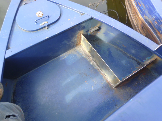

Some foot locker / seats a pair added to the wide-beam in the panel beating thread and a single to a Narrow- boat . Bowland Fabrications ltd Facebook page updated with more.

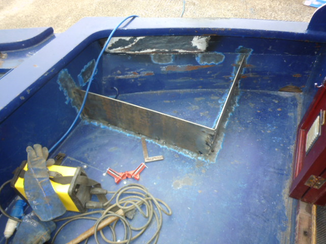

I'm curious as to the little red clamp visible in your last photo?
It looks like a corner clamp for doing work that is at 90 degrees, but can't make it out too clearly?

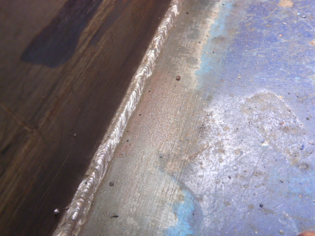

Welding a boat on the water is fun, especially with a 20 stone fire watcher who keeps moving about and the wakes of passing boats all create real movement. its like welding when someone keeps giving you little shoves anyhow some close ups first the easy one fillet in the flat the floor is 5mm- 6mm and a bit scaby the locker sides 5mm the rod 7018 ESAB 3.2mm
ok here is the v-up! and the excuses build " I was laid on my side" , " boat was rocking", "big uneven fit up", " it was a bit confined", " no place to prop" , its hard to extend up laid on your side" Anyhow got it done
Its a cheapo corner clamp for picture framing, good for the first tack in the top corner, then I went tack and whack down it. Silverline special about £3 not to be recommended for frames and gates or anything that basically "needs to be square" just use it as a third hand
Bessy do proper ones, they aint cheap though! you can also form your own and fasten the fitment on the inside of the joint with independent clamps. In the field like the above this aint very practical though as you might get perfect square and everything else isn't "its just got to look ok to the eye" and in the shop you can always clamp down to the bench if required.
Hi, are there "limber" holes in the locker/seats to allow water out?,just curious -- not criticising, I would love a boat but lack the funds and an enthusastic wife!!
Chris
I wish I knew what "limber" holes actually are anyhow yes everything must drain on a boat including the deck, otherwise it fills with water like a big bucket and finally sinks. I assume you mean the lower corners I cut some out from? there are then big sort of wash- out drains in the hull sides. Water still gets into the boat in place non the less and they are fitted with a pump in the lowest part of the hull (if it cant get out it will only fill) the risk as I have seen in last years re-build of a boat sunk in a lock is it don't take a lot to over balance a narrow-boat 1m3=ton that might be a few inches deep washed to one side?

Just looked you can see the big deck washout drain on the third picture
Inside the accom there should be no water under the floor boards unless either it has a leak, or it is a continuous bilge that extends under the bulk heads old boats use to not seen a modern boat recently like this (last 15years) except our mates, but that is over 40 years old.
