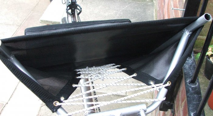

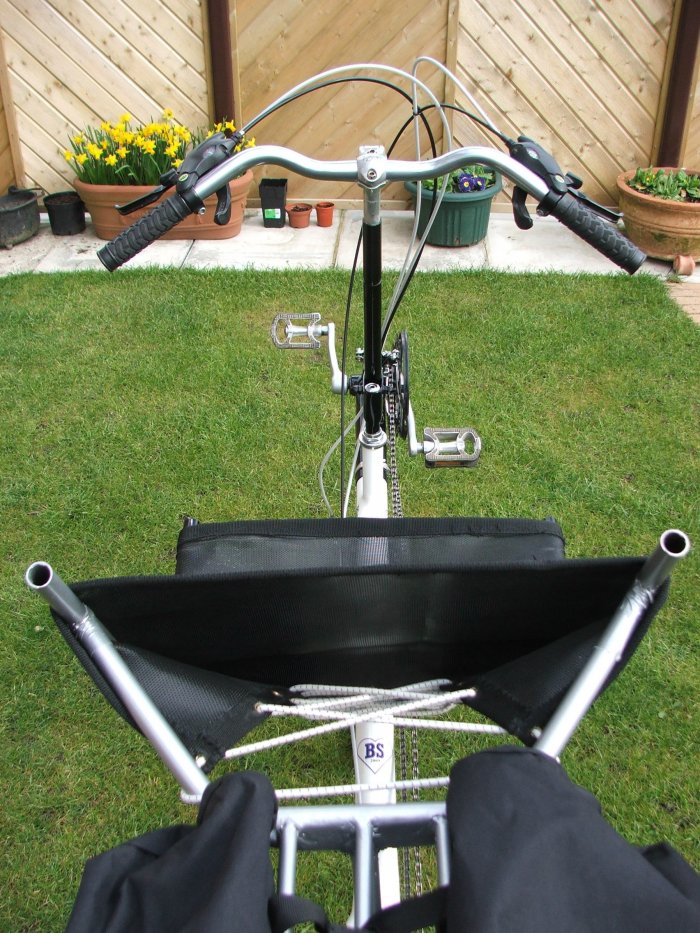

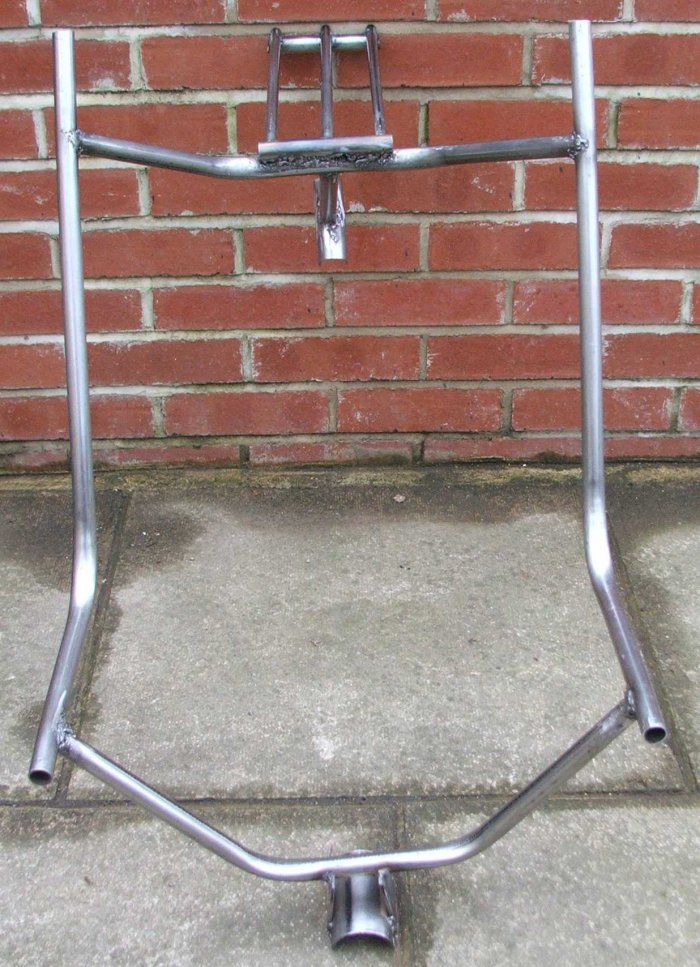

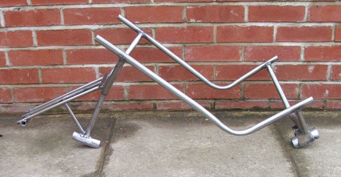

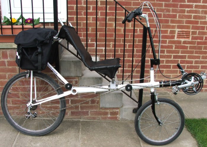

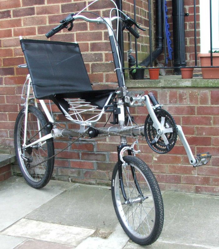

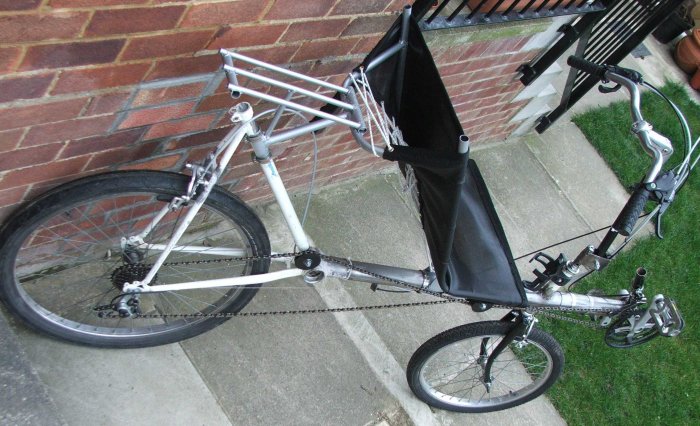

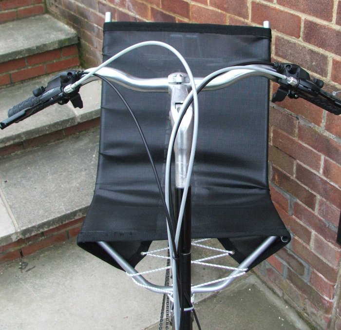

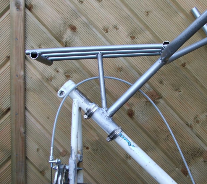

Messing about with some 19mm steel tube this weekend, borrowed the inlaws pipe bender he uses for bending copper tube. I have made a variation on the theme "Barnett Williams seat". I added a rack to the rear of the seat so that I can fix my bike bag onto it. Just ordered a 2mtre length of tramoline material to make a hammock style seat for comfort.

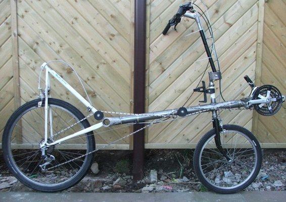

Now I am going to build SWB recumbent around the seat. Bought a 6mtre length of 2inch tube and other bits. I know its a bit odd doing it this way round but I was in tube bending mode and will find it more fun building the bike.

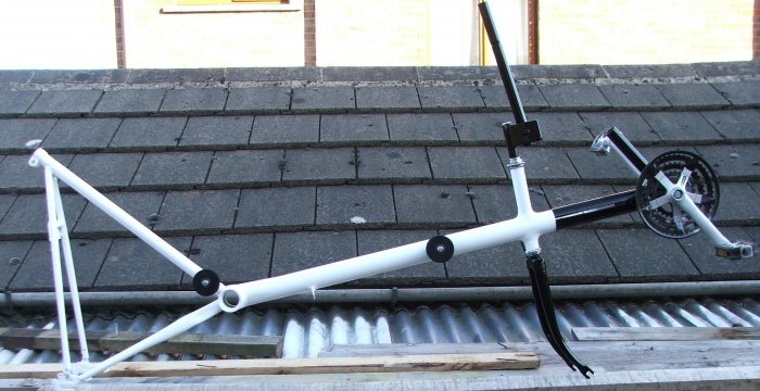

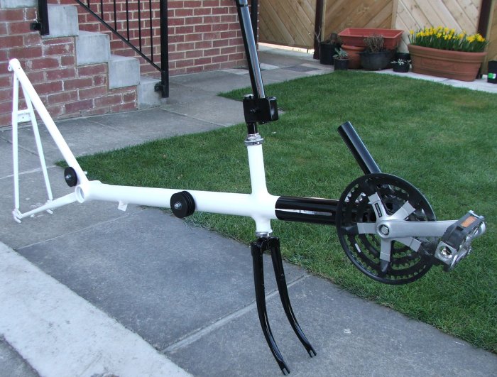

Then it will be stripped down and some paint slapped on it!

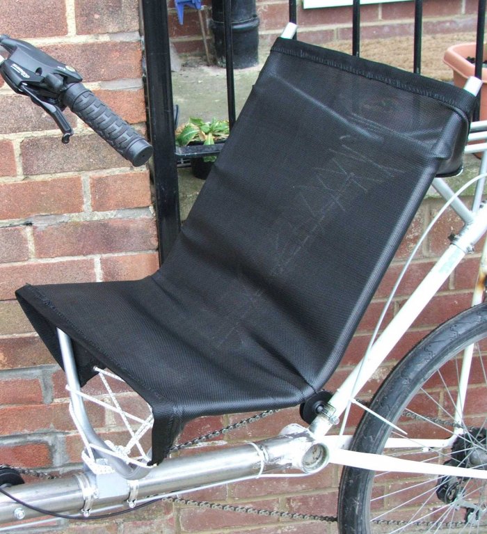

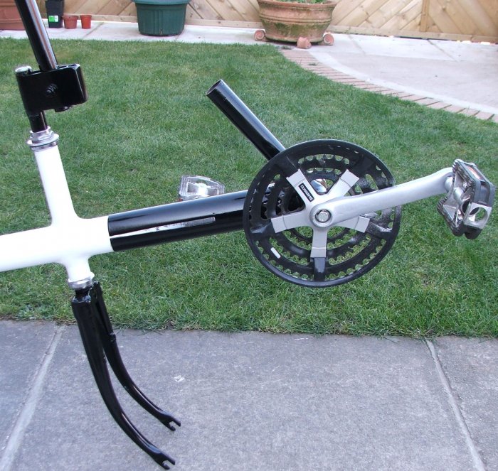

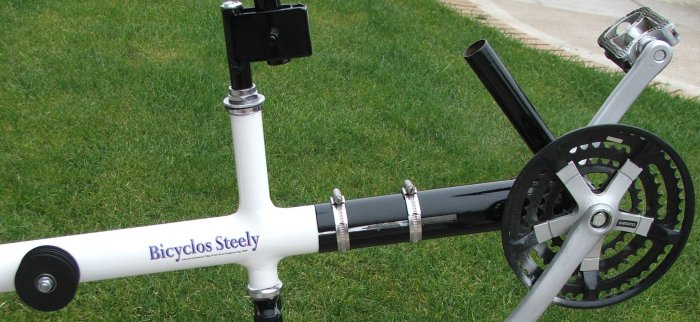

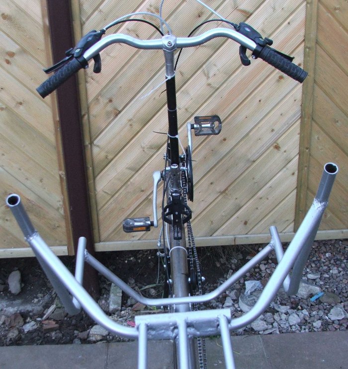

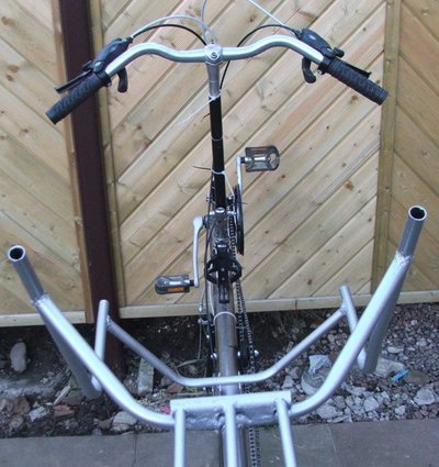

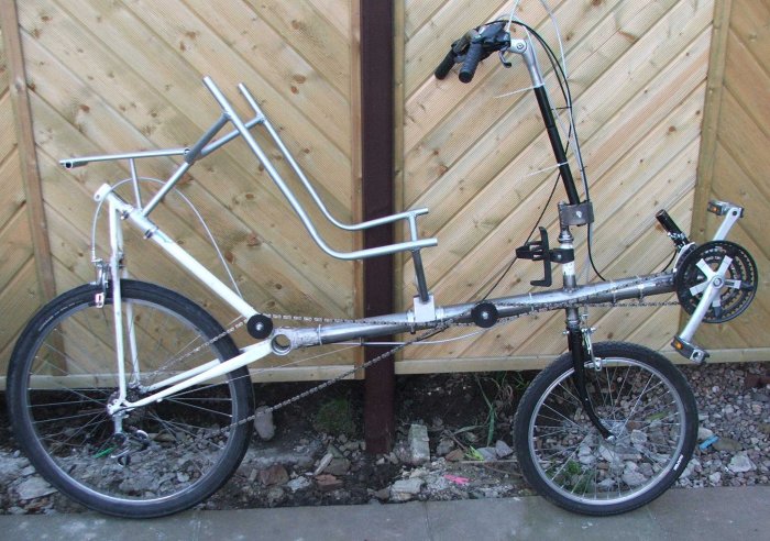

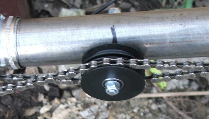

. i just could not resist doing a bit more on the recumbent.
