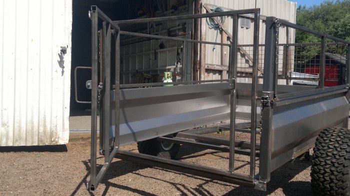

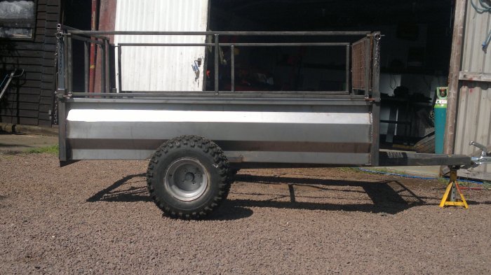

Some pics of the latest ATV trailer to come out of the workshop.

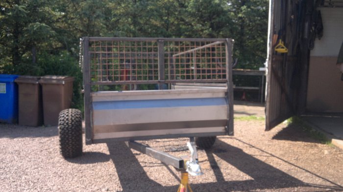

Its 7'x4' with 18" high profiled sides. Has 16" removable mesh extensions and removable mesh headboard.
The tailramp has an opening door in it to allow easy access for putting sheep into the trailer and will be finished off with aluminium chequer plate once its back from the galvanisers.

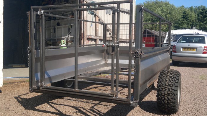

before the mesh was welded into the frames
full width hinge for the ramp to eliminate any gaps that can trap the feet of livestock
