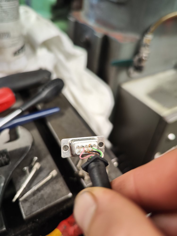

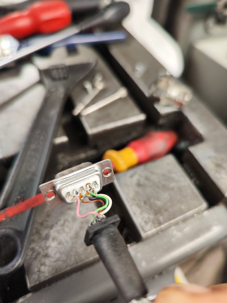

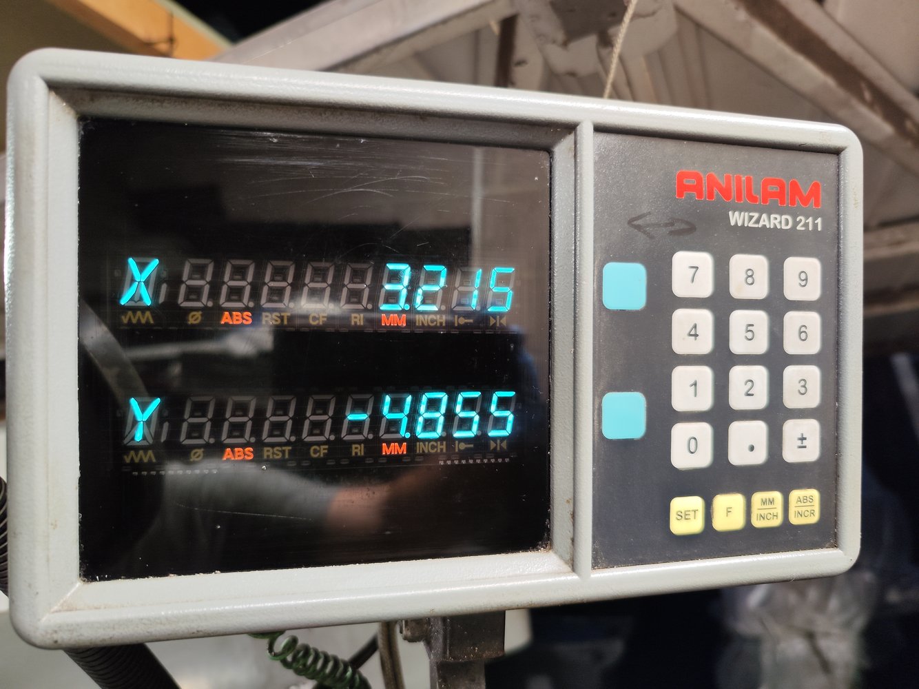

I have an Anilam Wizard 211 2-axis DRO that came with my Semco mill which works fine.

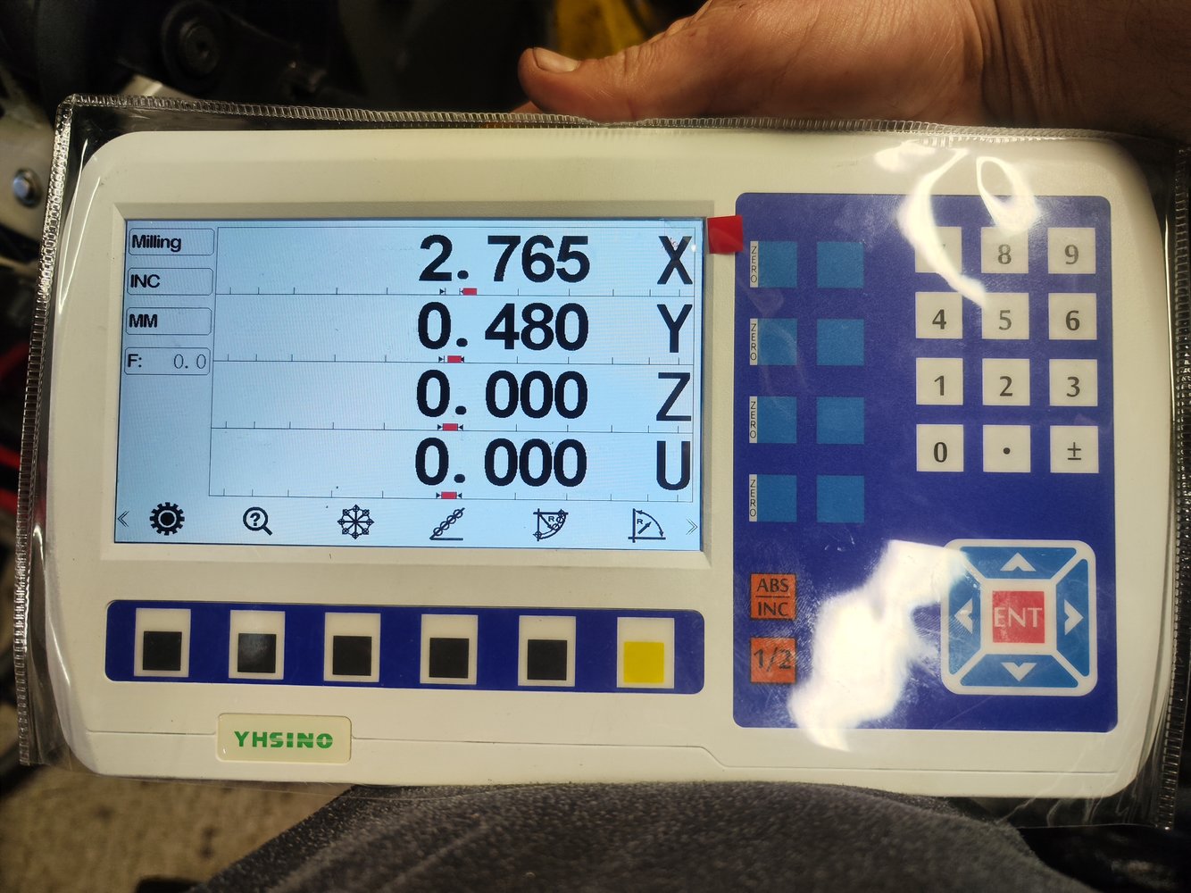

However, as it is only a 2 axis DRO I bought a Chinese 'upgrade' with 5 axis so I can have X,Y and Z. This Chinese DRO also have a summing feature so I can sum the quill and knee for one overall readout of the Z axis.
As the original Anilam scales are already installed, I was hoping can re-use them.

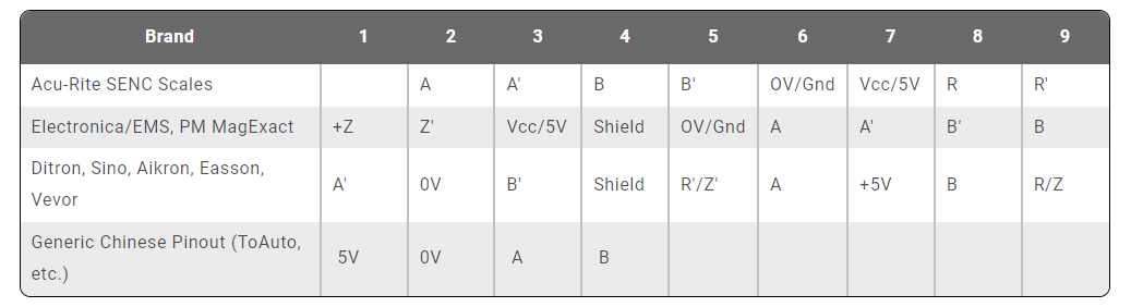

Problem: as we all know, scale pinouts/DRO pinouts are not all the same and unfortunately, the anilam scales do not work on the Chinese DRO.
Does anybody know the pin layout of the Anilam Wizard 211 DRO or the Anilam RBS-5T scales?
I can then just rewire the 9 pin D sub connector and all should be good.
The Anilam DRO manual and Anilam scale manual do not give the pin layout
Thanks!
