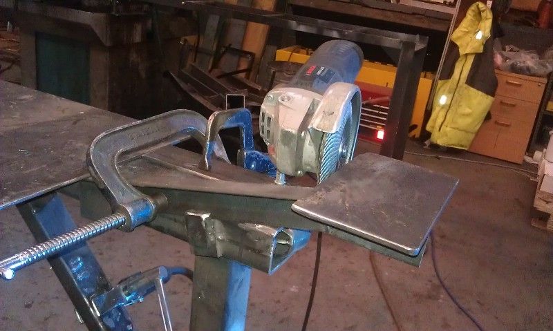

This is something I knocked up at work a couple of years ago. Its just an m10 bolt welded to a piece of angle with a nut to lock the grinder at the right angle. I was a bit worried at first about whether the grinders casing would be strong enough but i've never had a problem and its had a lot of abuse.
....ive made a collar to fit a grinder that accepts 115mm flap wheels...pics iff anyone is interested
