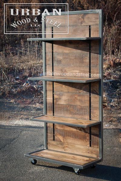

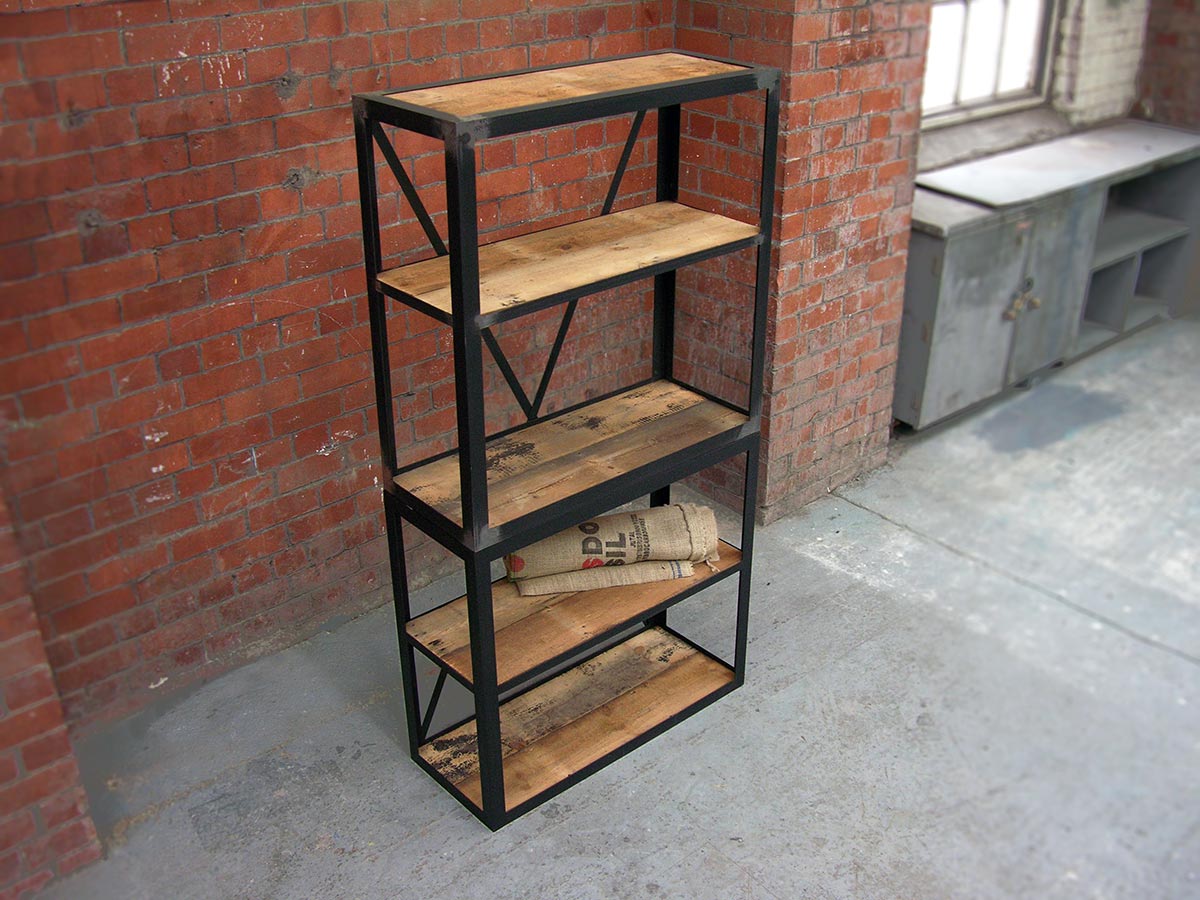

Make it out of small channel. Weld up, just leave one end open...slot the wood in, weld on last bit. Job done.
I like your shelves, they remind me of the ones where I did my apprenticeship that were full of drop forging tools and jigs, some made from 4" angle.
