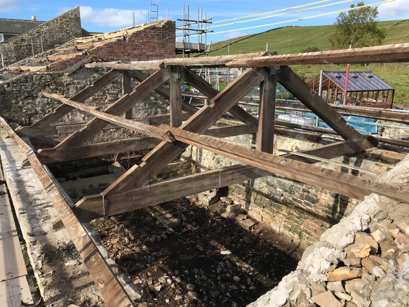

Storm Darragh did my elderly ole man's place somewhat of a walloping.
Went up & had a look yesterday & the woodwork is in a sorry state.
Like a lot of rural farm buildings of the time (not sure age, but I'd guess the place is 120-150yo, though the section in question is clearly a later add-on extension to the old Milking Parlour, but still stone-built (there's an RSJ in place of the old pine-end wall which was removed - I suspect its stone got re-used building the extension - so it's a wild guess at 60-70 years ago).
It all looks home-made & cobbled together on a shoestring & inventiveness (pretty typical).
There are 3 main A Frames, with horizontal interconnecting Rafters, then multiple vertically orientated 3 x 2" (I think) timbers laid on top, then the cross battens & slates atop that.
Everything above the A Frames is rotten & riddled with worm holes, so got to go.
The Timber Wall plate the 3x2's rest on its absolutely rotten through
My question is about the A Frames.
I think they are so big/thick that they would still be sound - if I could treat them & retain them, I could tackle the damaged half of the roof to get it water tight, then sort the other side at a later date.
But....

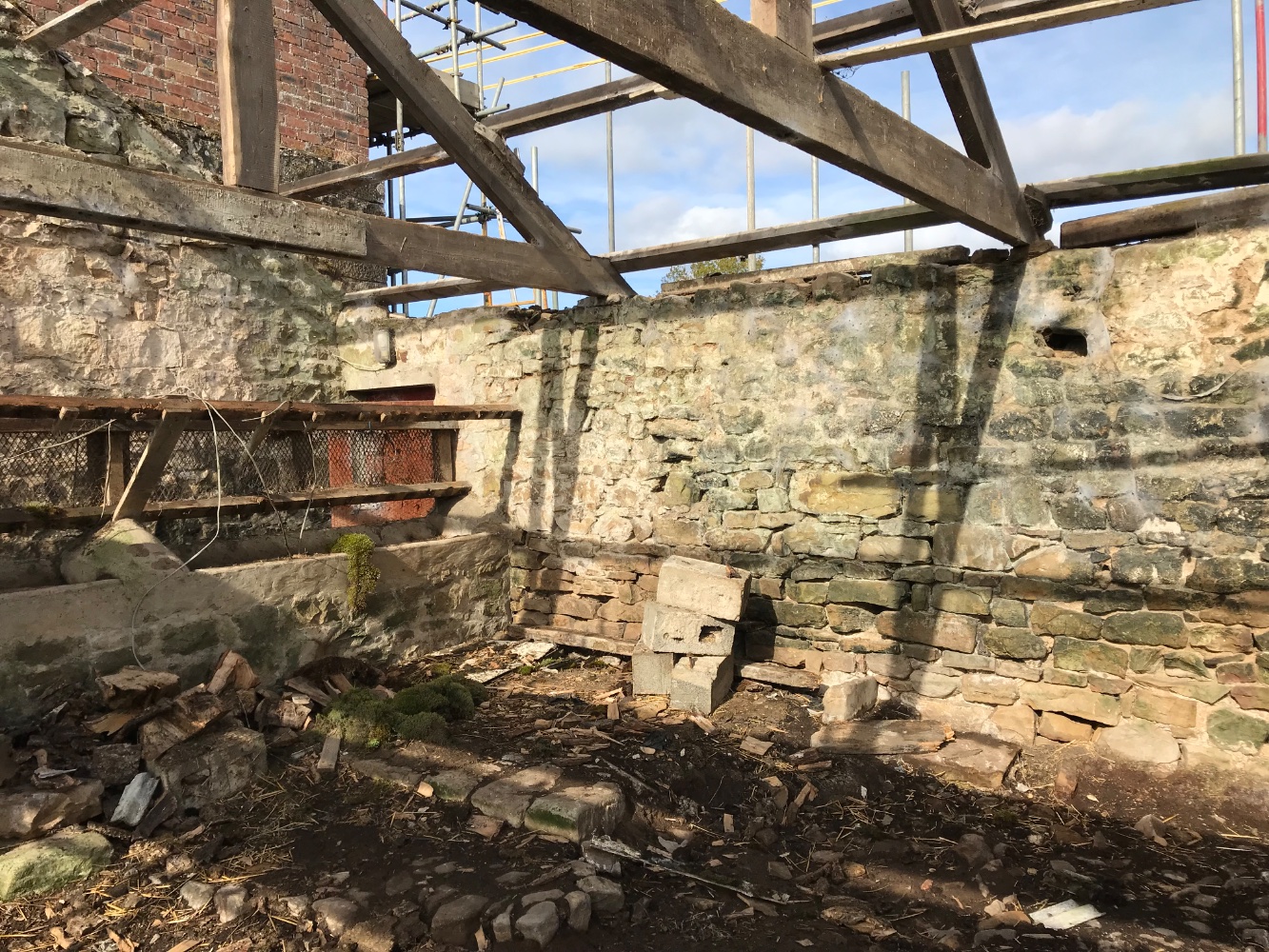

At least one of the A Frames (the others look ok) has a rotten foot on one end (on the side with the undamaged roof half as it happens).
Given this A Frame will have I think both compression and lateral loads upon it..... is it feasible to:
- acro-prop the frame to take the weight off the wall & the knackered section...
- cut the A-frame leg back to shoulder wood....
- splice in new timber & brace it (e.g. "splint" it either side of the cut, and drill/bolt with threaded bar to effect a sound repair.
It seems feasible to me.... but then I'm not a structural engineer or a Roofer!
