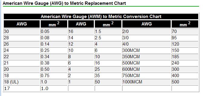

A amron Member Messages 162 Dec 3, 2011 #1 Is there any chart that shows what cross section area welding cable needed for a given amperage? Thanx.

shenion Tool Pack Rat Messages 7,586 Location Stone Mountain, GA USA Dec 3, 2011 #2 Search for "welding cable ampacity": Here is one example. http://www.pacificcabling.com/Specialty Cables/welding_cable_amperage_chart.htm Here is one that came with one of my welders: Most tables will be in AWG sizes. You can find the equivalent metric size: From: http://www.palonn.com/sommer_cable/awg_mm.htm
