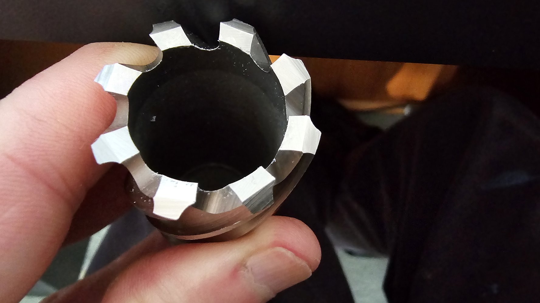

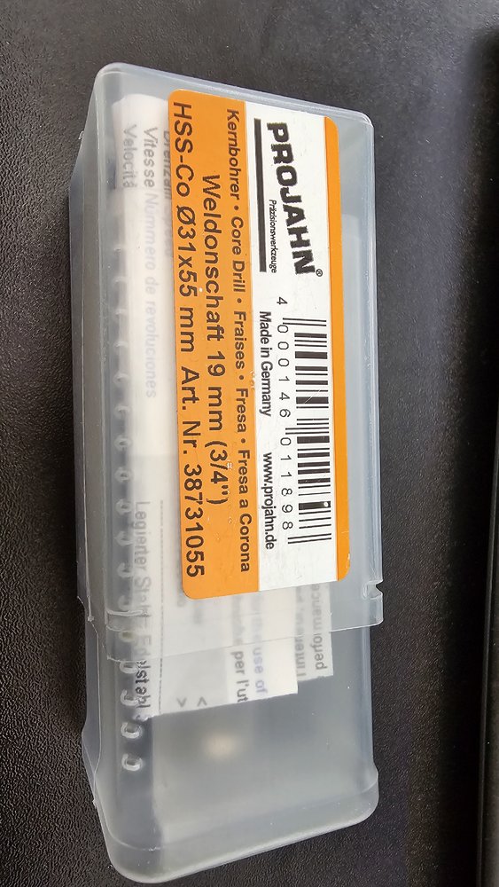

I was after a 30mm or 31mm roto broach cutter. Going rate seems to be about £35 to £50. Long series being more. Then I found this bargain on Amazon. £10 or so!

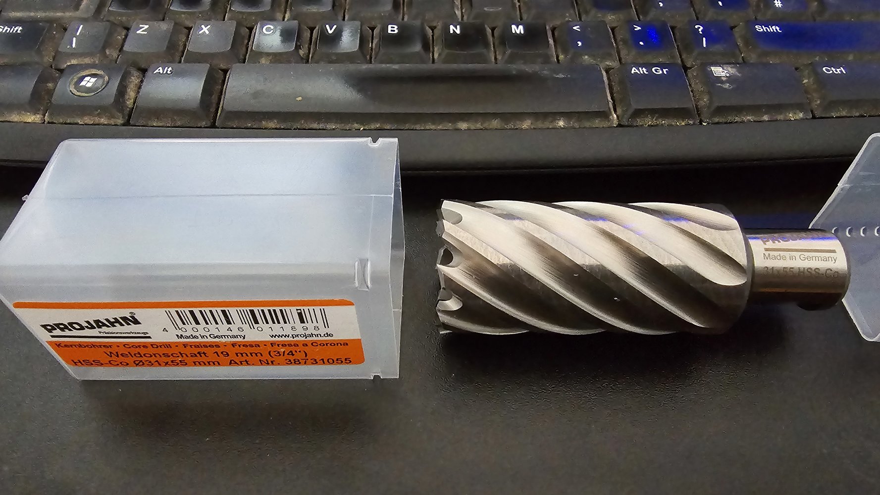

I thought it would be rubbish but it looks and feels great quality.
Never heard of the make before. Claims to be hss with 8% cobalt. Made in Germany not that I care.

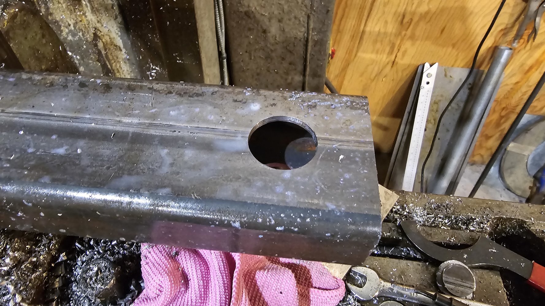

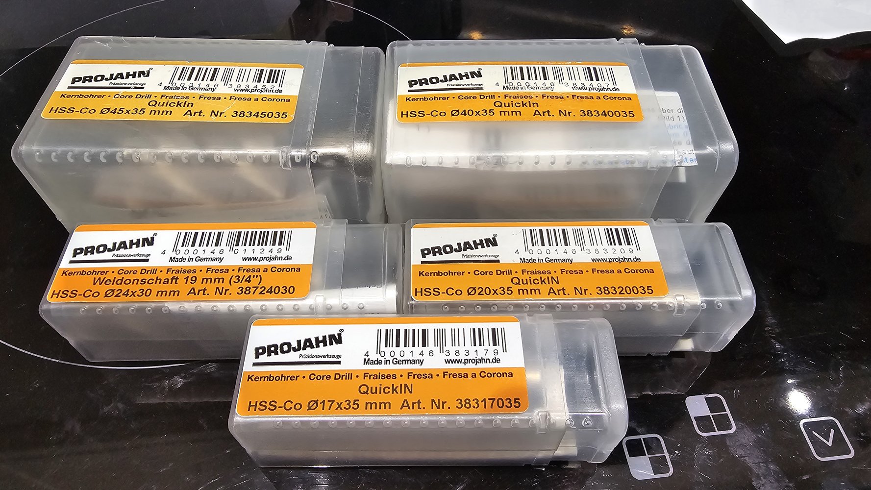

Worked perfectly so I ordered several other sizes. £11 for a 40mm and £5 for a 24mm. Crazy prices

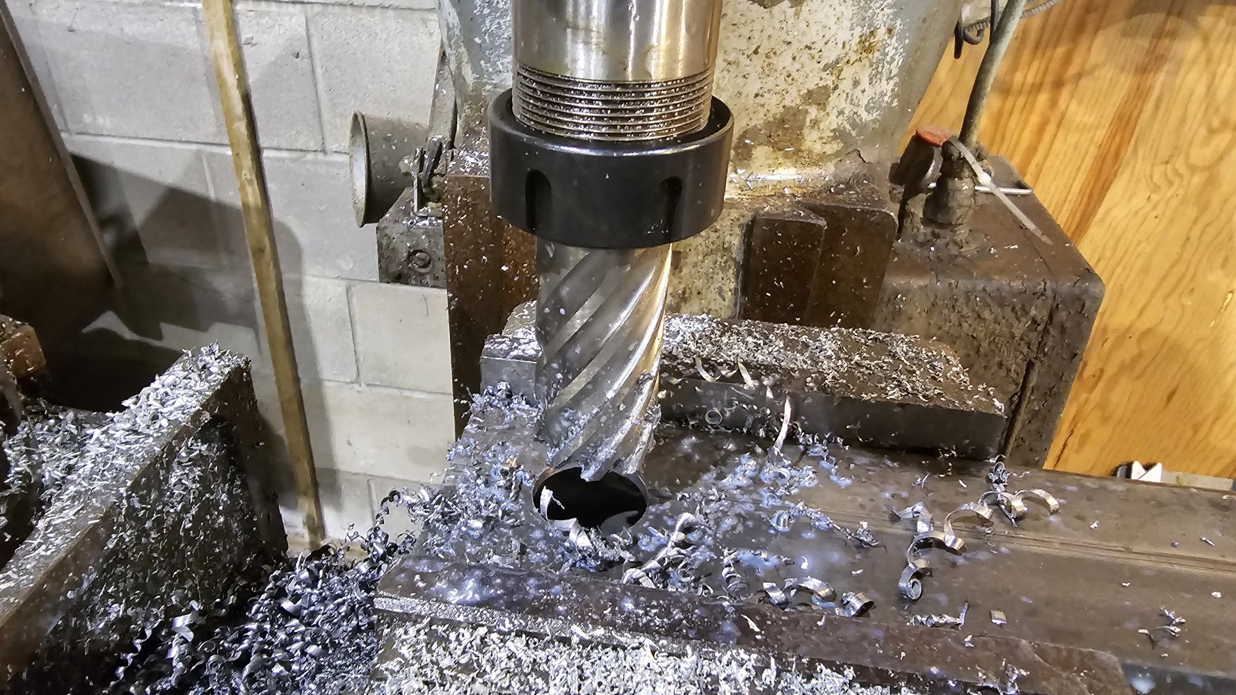

Oh and using my Bridgeport worked fine in an er32 collet. No need for a pilot drill nor a weldon adaptor.
