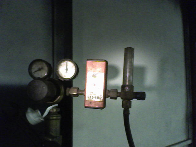

Does this make you think i don't like wasting mig gas.
Pic below shows a standard regulator, nothin speacial the sort that diywelding or weldequip will throw at you for less than £40. The orange box is a more modern version of the old gas miser,(weldequip and diywelding might remember these) basically it stops the build up of pressure that often occurs when the welder hasn't been used for a bit, ie when you pull the trigger you dont get the rush of gas, before it returns to normal flow. The last bit is a flow bobbin to give me accurate flow.
Does it make me tight?
