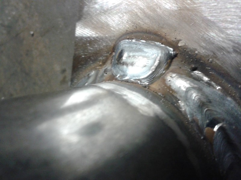

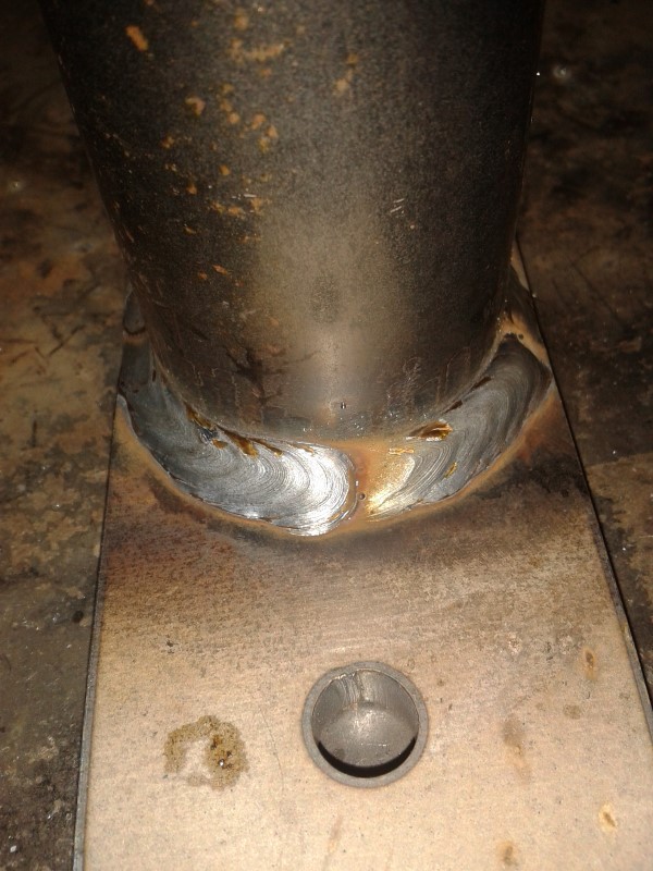

been welding 5mm to 5mm and some 3mm tube to 10mm plate, really struggling with penetration. its very hit and miss. i have attached a picture of just one of the welds and you can see it's not fused.
Machine, butters AMT 241, Gas shielded light at 20CFM MAX voltage (6). not sure on wirefeed rate i will work it out later if you guys wanna know it.
i have also had this problem on 5mm to 5mm fillet welds. maybe time to move up to a 20% argon blend?
