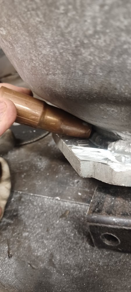

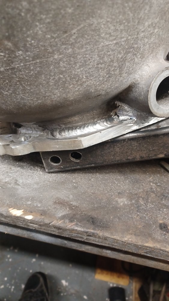

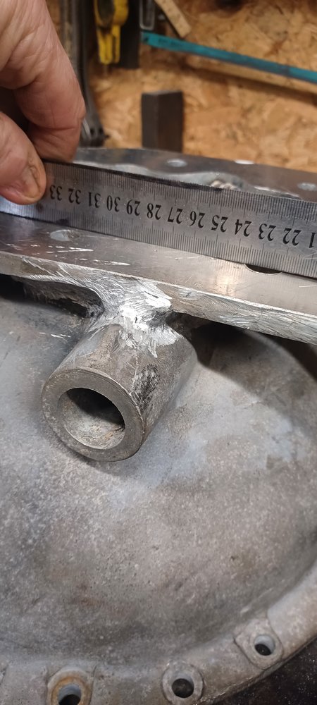

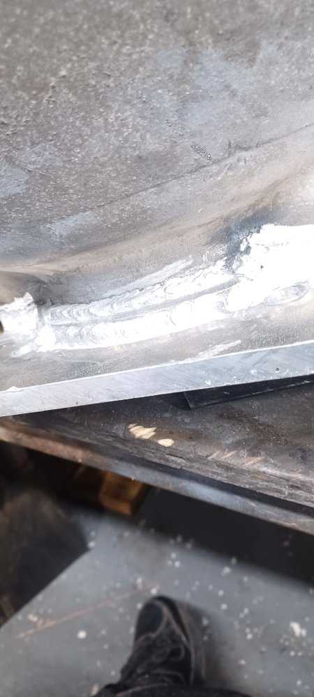

got involved helping to make the above conversion it entailed cutting the bell housing milling it flat and welding a thick alloy plate pre shaped and doweled in position once it was all set up on the engine
i used 1.2 5%mag wire and was around 29v with a wee crackle /spray.
access was tight in some areas so i had to look through 30 years of mig tips and nozzles to find the taper stuff good clean up an a roasting up to 200 and yee haw
turned out good bits of ferocity here and there but
ruff enough! lttle bit warp but plate is getting milled
we used 1/2
