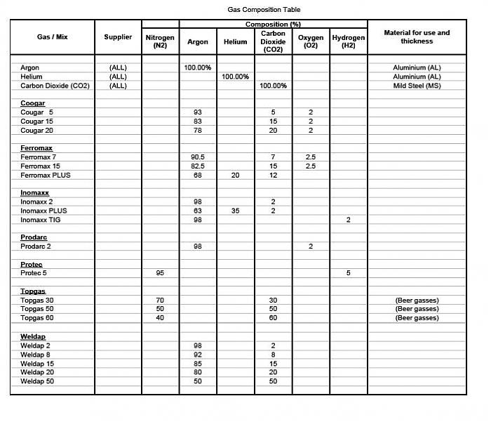

There are several other gases for welding available from air products such as the Astec and Hytec ranges but as I can't get my hands on the MSDS sheets I couldn't list the percentages properly, and thus didn't bother...
If necessary I can look into it should it become a necessity...

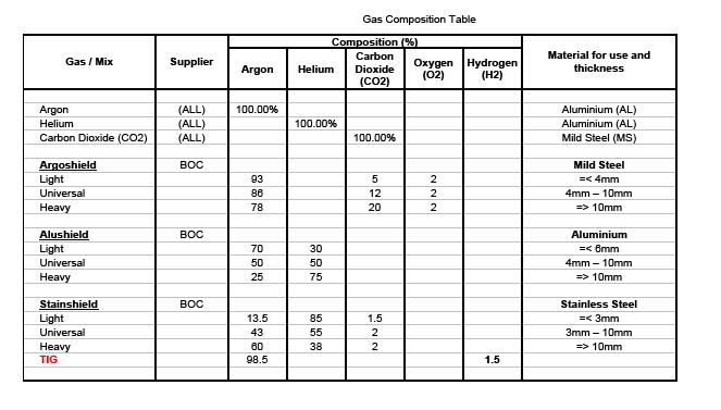

FYI - Argoshield Light from BOC cost me ~£25 for a fill and ~£35 for a years rental of a X sized cylinder + ~£30 for delivery (have got good access to where I live and as I dont drive its a bonus).
This size is more than enough for basic MIG welding and although steep at first over a year is nothing...
If I pick up it's about £10 handling charge so plan on attempting that when I need to...
Air Products gave me an awful quote and said they wouldn't deliver so had to ditch them unfortunately...
