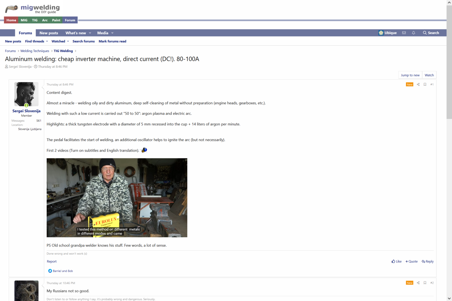

Almost a miracle - welding oily and dirty aluminum, deep self-cleaning of metal without preparation (engine heads, gearboxes, etc.).
Welding with such a low current is carried out "50 to 50": argon plasma and electric arc.
Highlights: a thick tungsten electrode with a diameter of 5 mm recessed into the cup + 14 liters of argon per minute.
The pedal facilitates the start of welding, an additional oscillator helps to ignite the arc (but not necessarily).
First 2 videos (Turn on subtitles and English translation).
PS Old school grandpa welder knows his stuff. Few words, a lot of sense.
