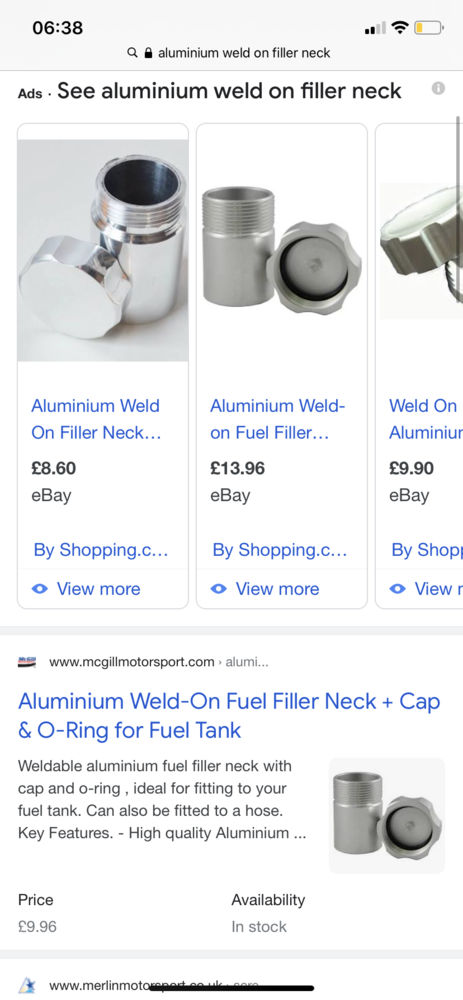

C Cheesie Member Messages 1,259 Location Lisburn Feb 11, 2021 #1 I'm making a water tank to sit on top of a dog box, just ordered a weld on filler before I realised it would need to be vented for frosty weather, i can only find motorcycle type caps which are to expensive, am I over thinking this

C Cheesie Member Messages 1,259 Location Lisburn Feb 11, 2021 #4 Not vented though I ordered the bottom one before thinking
8ob Member Messages 14,366 Location Nescient in the vale Feb 11, 2021 #5 Grind a vertical slot in the thread. Bon.
mike os just a little insane..... Messages 9,652 Location North Wales Feb 11, 2021 #6 Drill a small hole in the cap
pedrobedro Man at Matalan Messages 13,119 Location CX near Chesterfield Feb 11, 2021 #8 mike os said: Drill a small hole in the cap Click to expand... Fit a chainsaw tank breather or similar to the tank or the cap.
