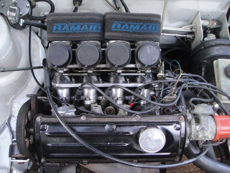

Hi everyone, after putting up a thread recently asking for help with welding up a stainless inlet manifold, and finding all the advice a massive help, I thought I would do the same with the aluminium one I am attempting. It has another 10mm flange in place of the metal gasket underneath the tubes which isn't in the picture;
Basically I am just finding it difficult to create a weld pool on both the surfaces to be joined, and the filler rod just wicks and drops off no matter the angle. I got the gaps between the surfaces mega tight as I know this is supposed to help. The runner tubes are 2mm thick and the manifold flanges are 10mm. I am using a 2.4mm tungsten and 4043 filler at 120 amps on AC. AC balance is around 50%.
After having similar problems with stainless and being advised to shorten my arc length to around 1-2mm (which helped), I thought it must be the same solution with aluminium. But the closer I got all it seemed to do was draw any filler material towards it like a magnet, so I end up touching down and contaminating the tungsten.
What sort of arc length should I try to keep?
The other problem I was encountering is the filler wicking before it reaches the weld pool. I have seen plenty of tutorials on ali TIG and they all say that the angle of approach should be 90degrees to the torch, but this just would not work for me. The only way I found it to wick less was when I directed it in at around 45-60 degrees to the torch?! What angle should I aim for?
I have actually completed the welding on it and I will get some pics up to show how it turned out
Some of the welds came out really neat, but the majority of them were a blobby mess. Hopefully someone will be able to offer me some advice.
