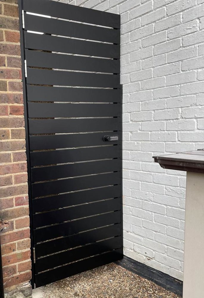

50x25 posts
3no stainless hinges
Black stainless horizontal combination lock
100x5 flat with 15mm space
Powder coated Matt black
Little stitch welds on the back of the flat to the frameworkIs it all welded construction ?
Looks good !
