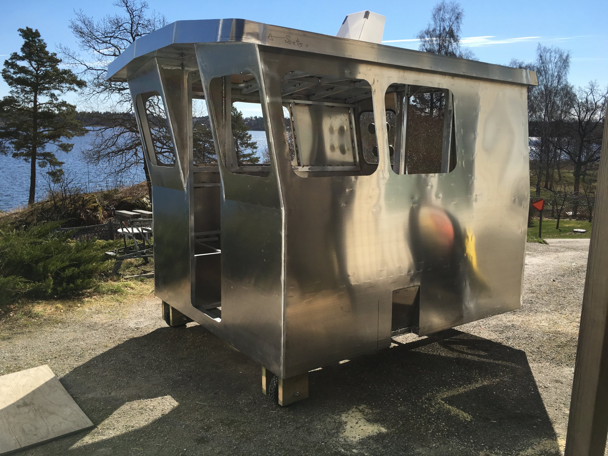

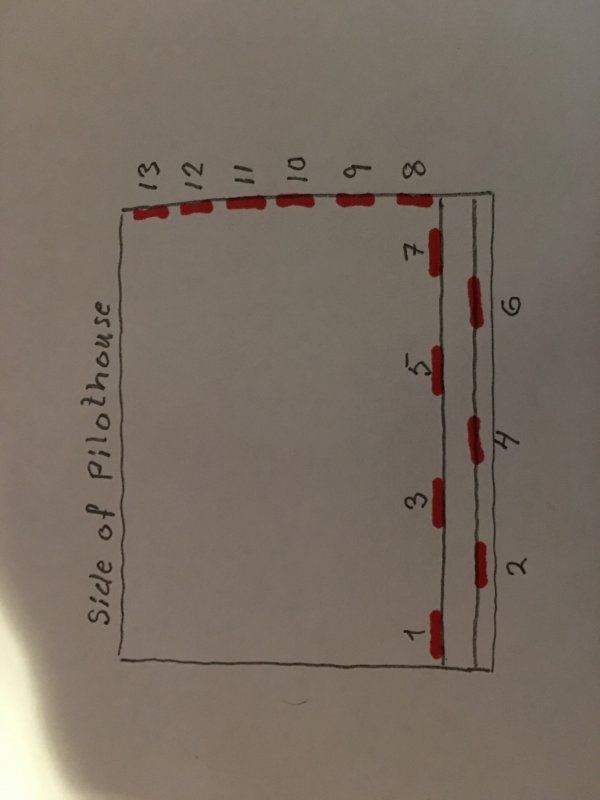

Hi I am going to build a new pilotehouse for my boat . It is like a square box 2.5 m x 2 m and 2m high It is buildt on a frame rectangular tube 100x50x4 mm. Plates are marine grade 4 mm Aluminium. Inside corners will be mig welded to 30% and outside corners tig welded all the way.
. I will tack the construction toghether before I start final welding. Can anyone advice in which order the welds shall be done so distorsion of the plates will be as small as possible. // Bo
