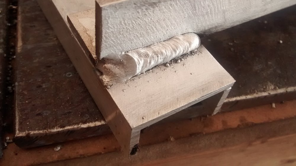

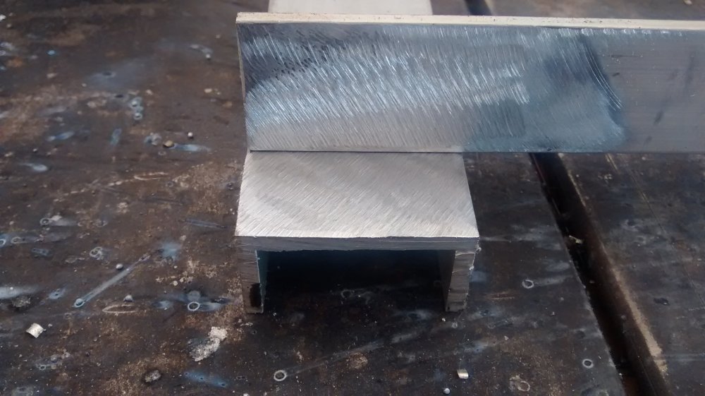

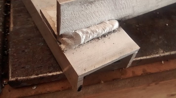

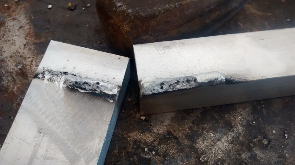

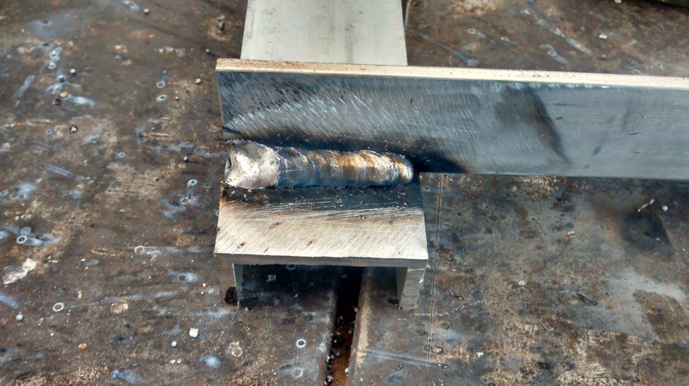

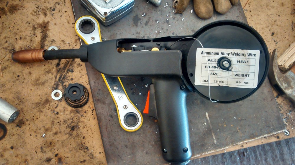

Wonder if I could borrow on the experience here. Bought the cheap ali MIG gun from Ebay.. you know the one (if anyone wants details of my experience PM me).. now it seems to work okay, welds look okay, bit cold but okay. However when I came to a destructive test the body of the weld looked like an Aero!
Set up:
Material - 1/8 equal angle to 1/8 channel freshly cleaned (prob 6082)
Gas - pure Argon at 30l/min (high I know.. it's the same at 7l/m and 15l/m)
Plant - Clarke 255 with Ebay gun
Wire - 0.9mm 4043 (came with the gun)
Transfer - short circuit
Gun angle - about 15 degs leading
The problem is pretty clear from the pics. Any ideas anyone?
