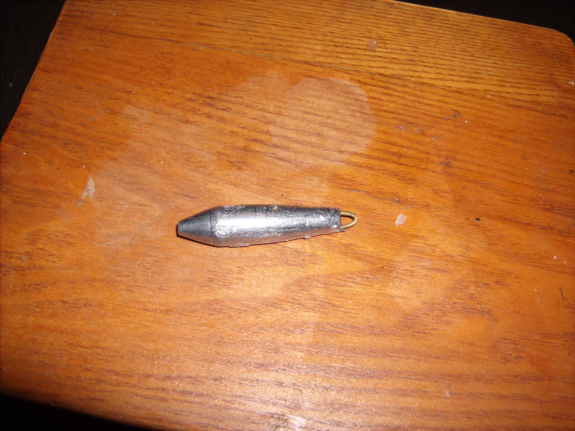

First time I poured melted alumin in a mould it cooled with a big recess in the top centre, appeared to contract on cooling, any way to fill this, or is it a case of making the mould longer than needed and cut the bad end off?
