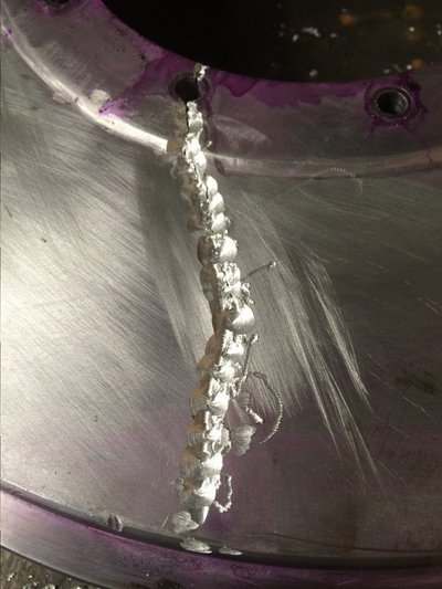

Got a repair to do on an YAMAHA TZ250 (I think that's what it is). It's a bit of ali box to the casting that houses the shock and swingarm bearing. The original weld (25+) years old has cracked half way round. I'm planning on grinding out with a deemed and carbide tip, then rewelding with 4043, as it is on to a casting.
Does this sound about right?
