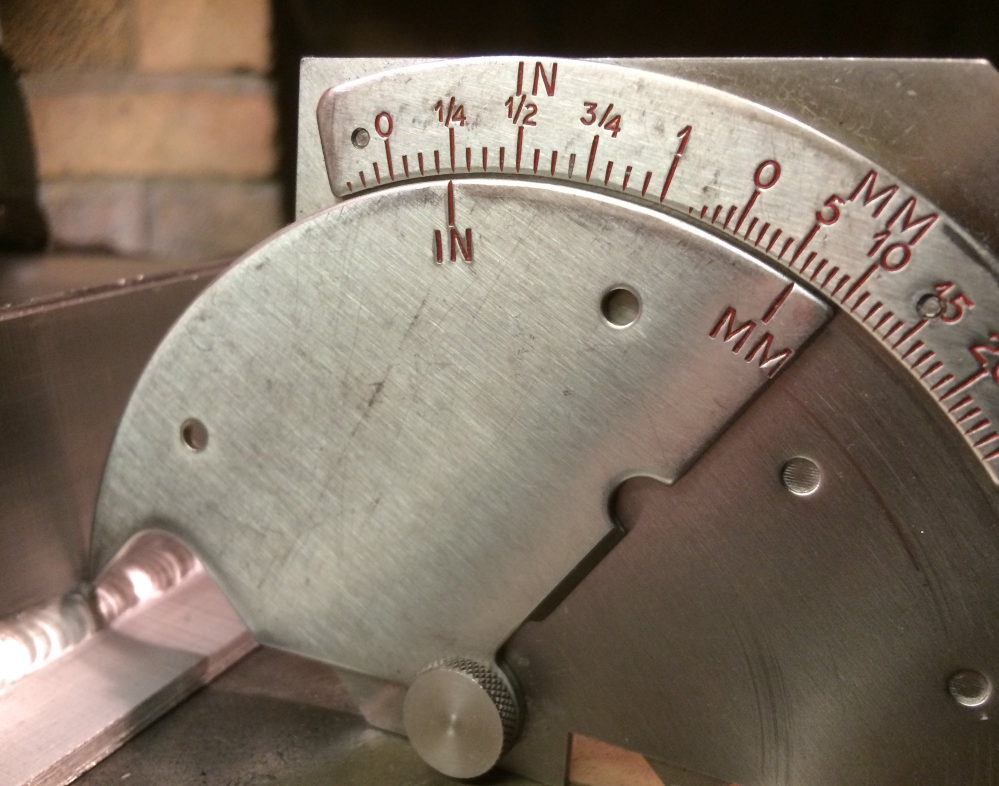

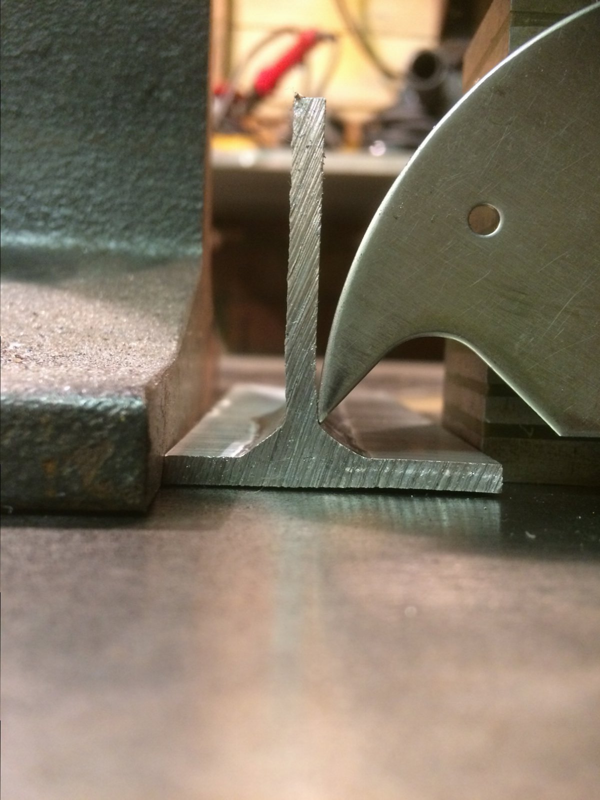

SLooks tidy that mate. What settings you used? Was your joint tight up, I think the minor gap I'm having to contend with isn't helping I'm no pro so could be wrong.
hi mate. Yes the best settings I found from those are.Looks tidy that mate. What settings you used? Was your joint tight up, I think the minor gap I'm having to contend with isn't helping I'm no pro so could be wrong.
On a torch switch 135 amps.
Balance @ 80% dc-
Frequency @ 160 hz
2.4 tungsten sharpened up like a wax crayon angle.
2mm filler.
Arc length gap about the thickness of a fag paper. (Most of the time
