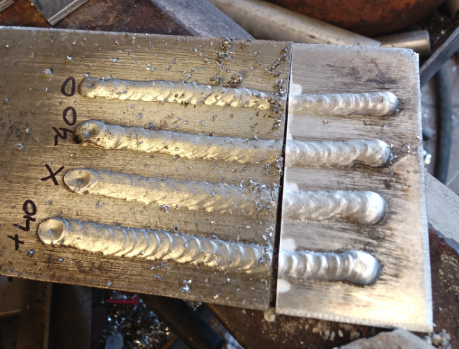

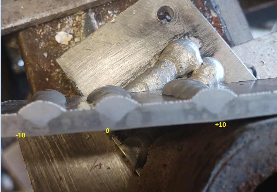

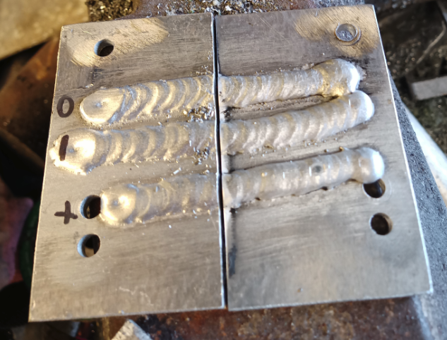

Just did a test with some Aluminium and altering the choke.
I was expecting that with maximum positive (+40) it would have better penetration and with minimum negative (-40) it would have less but here are the results.
First test with plate cooled in water before each run.
0 choke at top then -40 and then +40

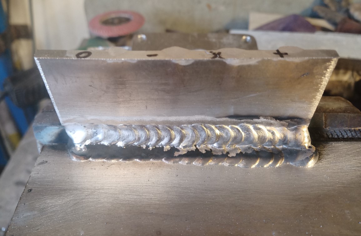

The etch.
Penetration edges it with the -40 I would say.

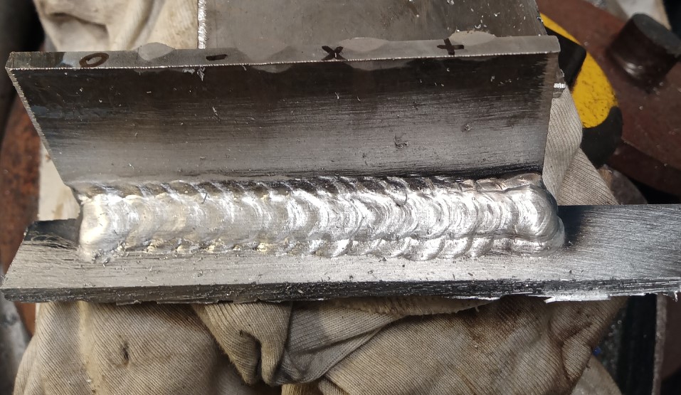

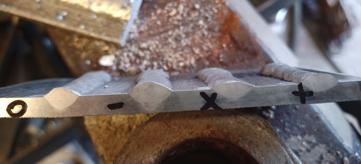

Then did another test after I had altered the pulse settings.
The one with the X at it should be ignored as I forgot to cool.

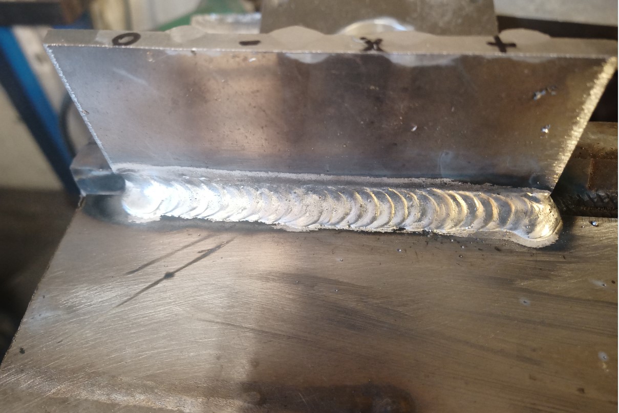

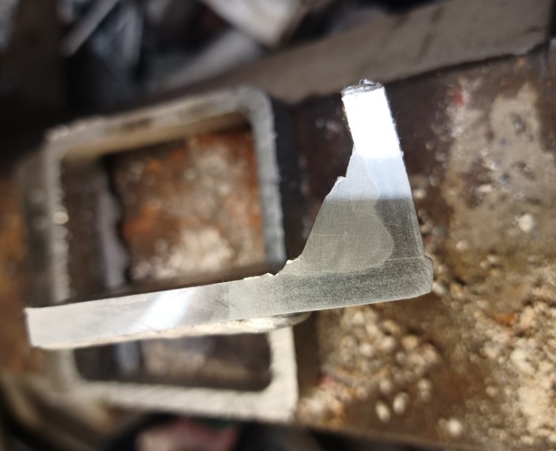

The Etch, the -40 walked away with it for sure this time.
I wasn't keen on the -40 arc but I think I might try experimenting with maybe -5, -10 etc and see which I like the best.
