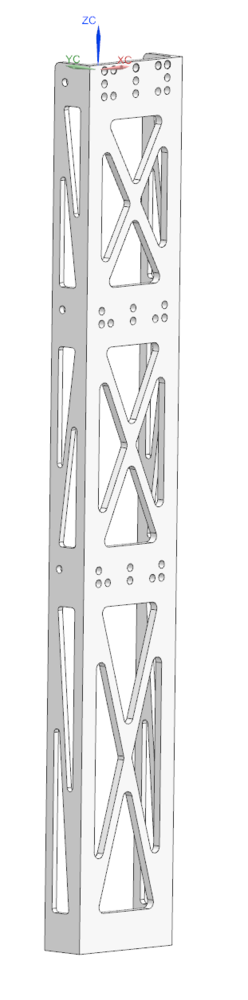

mike os just a little insane..... Messages 9,777 Location North Wales May 12, 2022 #1 I need to put some aluminium channel on a diet..... See pic The section is a 204 x 75 x 12.5 6082 about 1400 long Do you think it will remain straight? I was wondering if the windows in the flange should change to rectangles

Deltic Member Messages 94 Location Essex, UK May 12, 2022 #2 Which direction is this being loaded from?
mike os just a little insane..... Messages 9,777 Location North Wales May 12, 2022 #3 Deltic said: Which direction is this being loaded from? Click to expand... Along the long axis
mike os just a little insane..... Messages 9,777 Location North Wales May 12, 2022 #4 Deltic said: Which direction is this being loaded from? Click to expand... It’s strong enough for it’s intended purpose, I just can’t dec if it’s going to bow when cut out

Paul. Moderator Messages 7,047 Location Northampton. UK May 12, 2022 #5 If you cut it cold, ie jigsaw or waterjet cutting is should stay straight, and if it doesn't it will straighten easily enough, thermal cutting methods, laser or plasma may distort it though.

gaz1 Member Messages 20,516 Location westyorkshire May 12, 2022 #6 cut it out like a steel beam then if in horizontal use the truss method as willl be stronger yours is not based on a truss method

mike os just a little insane..... Messages 9,777 Location North Wales May 12, 2022 #7 Plan is Waterjet cut
Paul. Moderator Messages 7,047 Location Northampton. UK May 12, 2022 #8 mike os said: Plan is Waterjet cut Click to expand... Should be fine then,
