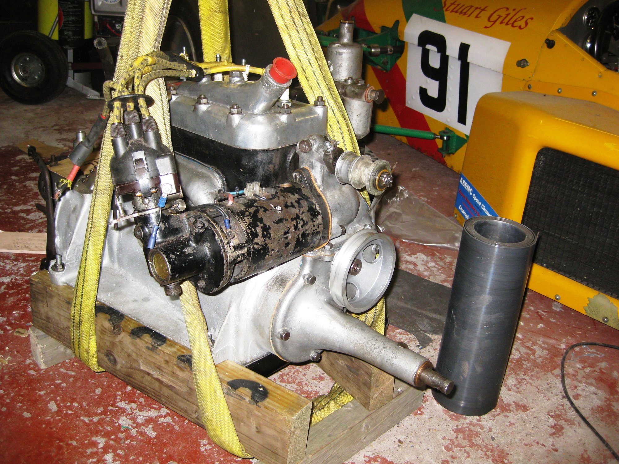

What sort of room is there around it in the bay? There is a belt drive that could be used to drive a dinky little alternator and leave the existing dynamo where it is as a jackshaft.
That is what a lot of people have done, and may be the thinking behind the the OP's question about running an an alternator "backwards". The fan pulley on a coil ignition A7 motor is mounted on the front of the camshaft. As the cam is gear driven it rotates in the opposite direction to the crank. It's a fairly simple matter to weld some brackets to the top of the A7 dynamo casing and mount a belt driven alternator there.
Another solution which leaves the underbonnet looking original is to drive an alternator from the propshaft. I've done this conversion a few times for friends. There's a bit of jiggery pokery needed to get a taper bush style pulley mounted on the shaft. Firstly, need to get some weight off the pulley; you really don't need another flywheel on the propshaft.
Then there's the "ship in bottle" issue of the taper bush not going over either end of the propshaft. dowelling it and splitting it fixes that.
This is the pulley assembled on the shaft, this is as far forward as the pulley can go if the car still has the original cable brake cross shaft. This particular setup has been on the car and working for a few years now.
