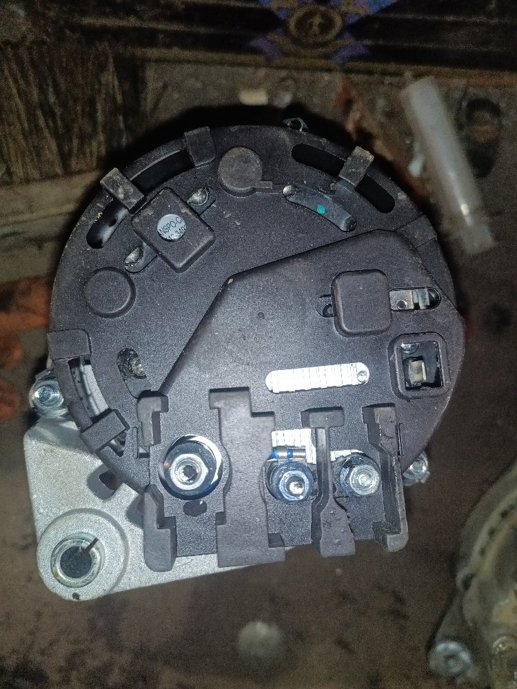

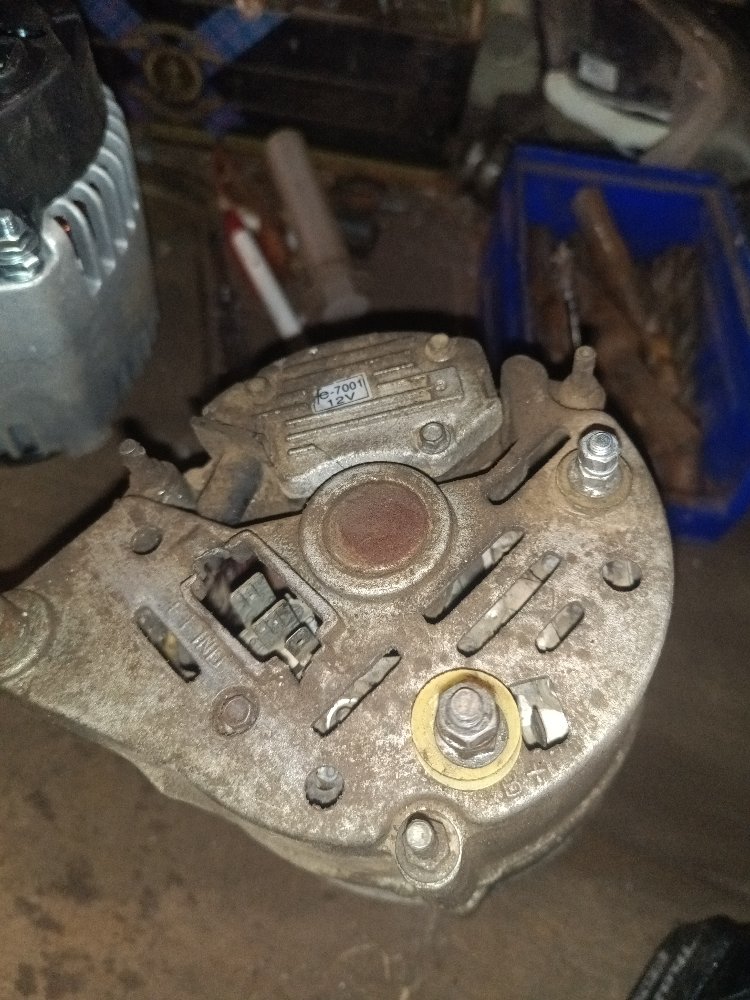

Got a new one to stick on the perkins powered fermec 860 digger, but its a bit different to the old one.
Old one had a 3 pin connector plus a small wire with a ring terminal.
I figured 2 of the pins are both heavier wires that go to the positive on the starter, the other pin on that connector is a smaller wire, that is a switched ignition live,
The other small wire with the ring terminal i was presuming is the W terminal for the tacho? Strangely though that was attached to a post on the old alternator stamped B+ which i thought was usually battery positive?
The new alternator has 3 posts and another spade terminal, but nothing is marked!
I think from google lensing it, the 3 posts are battery positive on the left, switched live/charging light in the middle and the W on the right,
any thoughts?!
cheers
