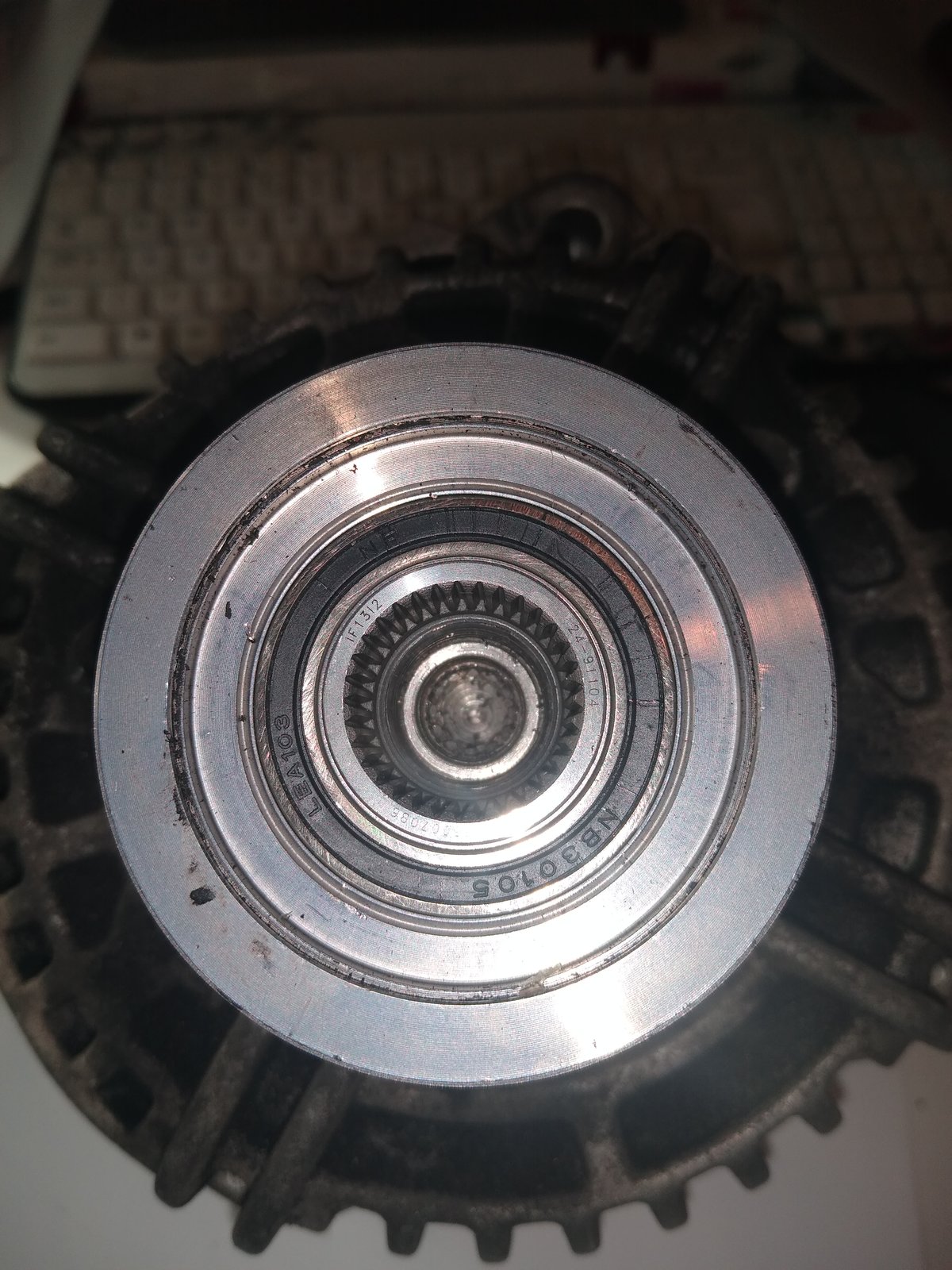

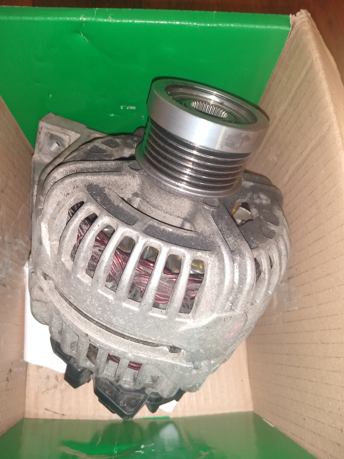

Recently replaced an alternator on a v70....the old one was an ebay jobbie that I fitted a few years back. The only issue with it is the free wheel pulley has siezed which was slowly destroying the aux belt (ultimately that would have destroyed the engine on a v70!)

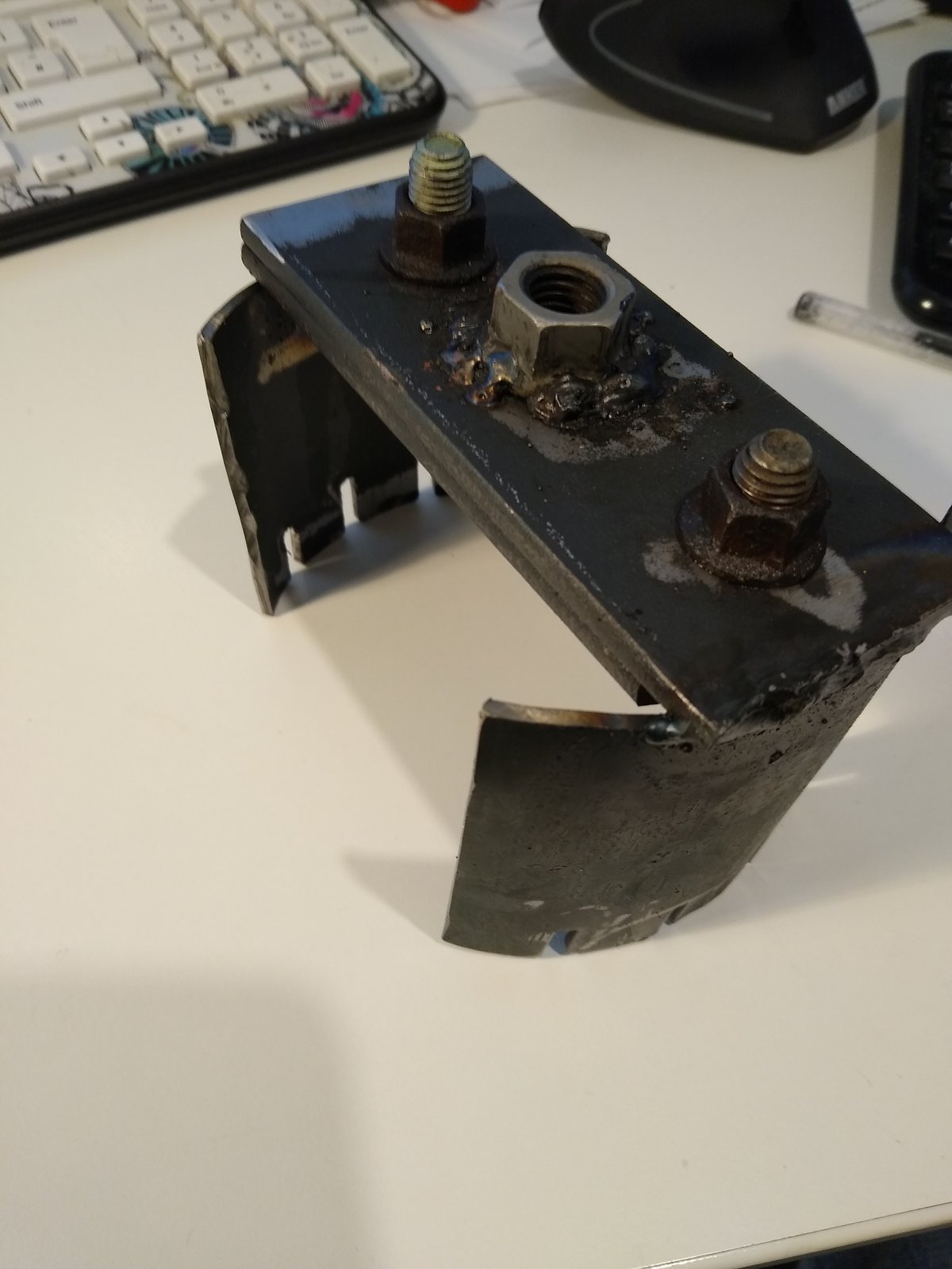

So....I decided I might just swap the pulley but the tooling is non standard it seems so my regular tool set for pulley swaps doesn't fit.
Does anyone recognise the tooling or have a suggestion which doesn't involve an angle grinder.
Current tool is a Sealey SX400....maybe I just need to buy a different set....but which one!

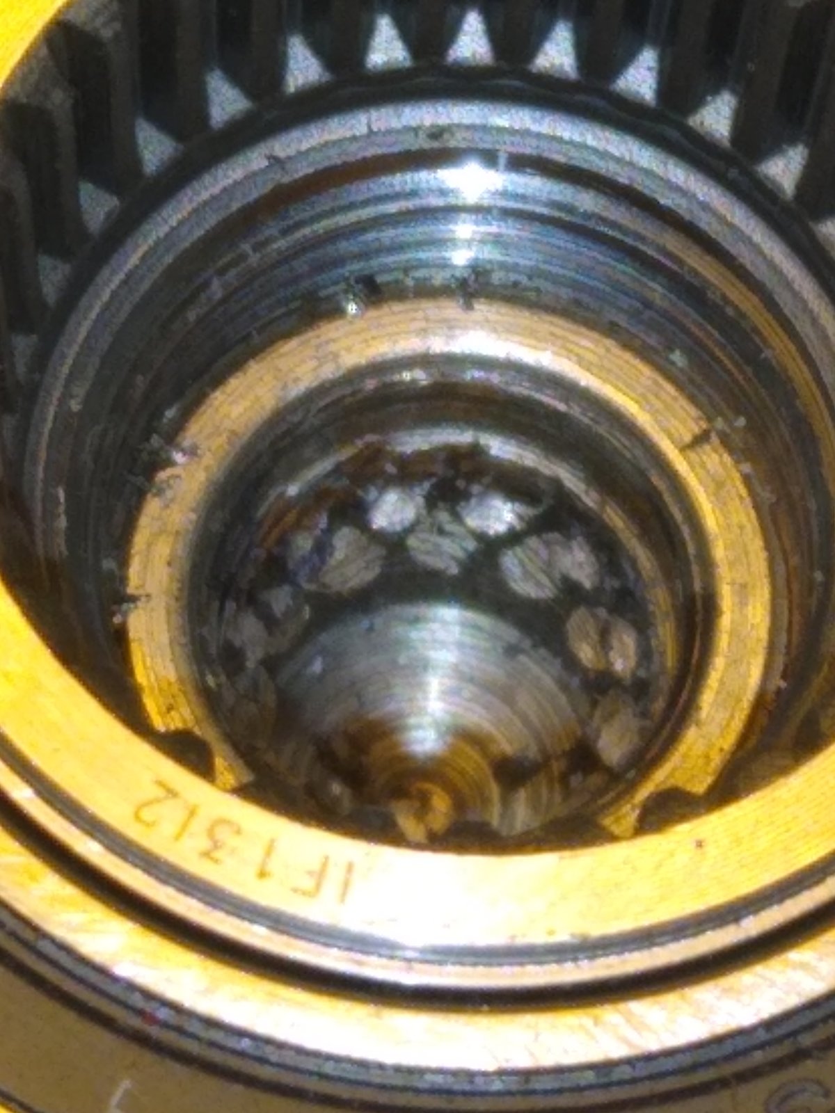

The outer ring that holds the pulley is fine....it's the inner ring thats the issue as it isn't splines but looks like toothed!
