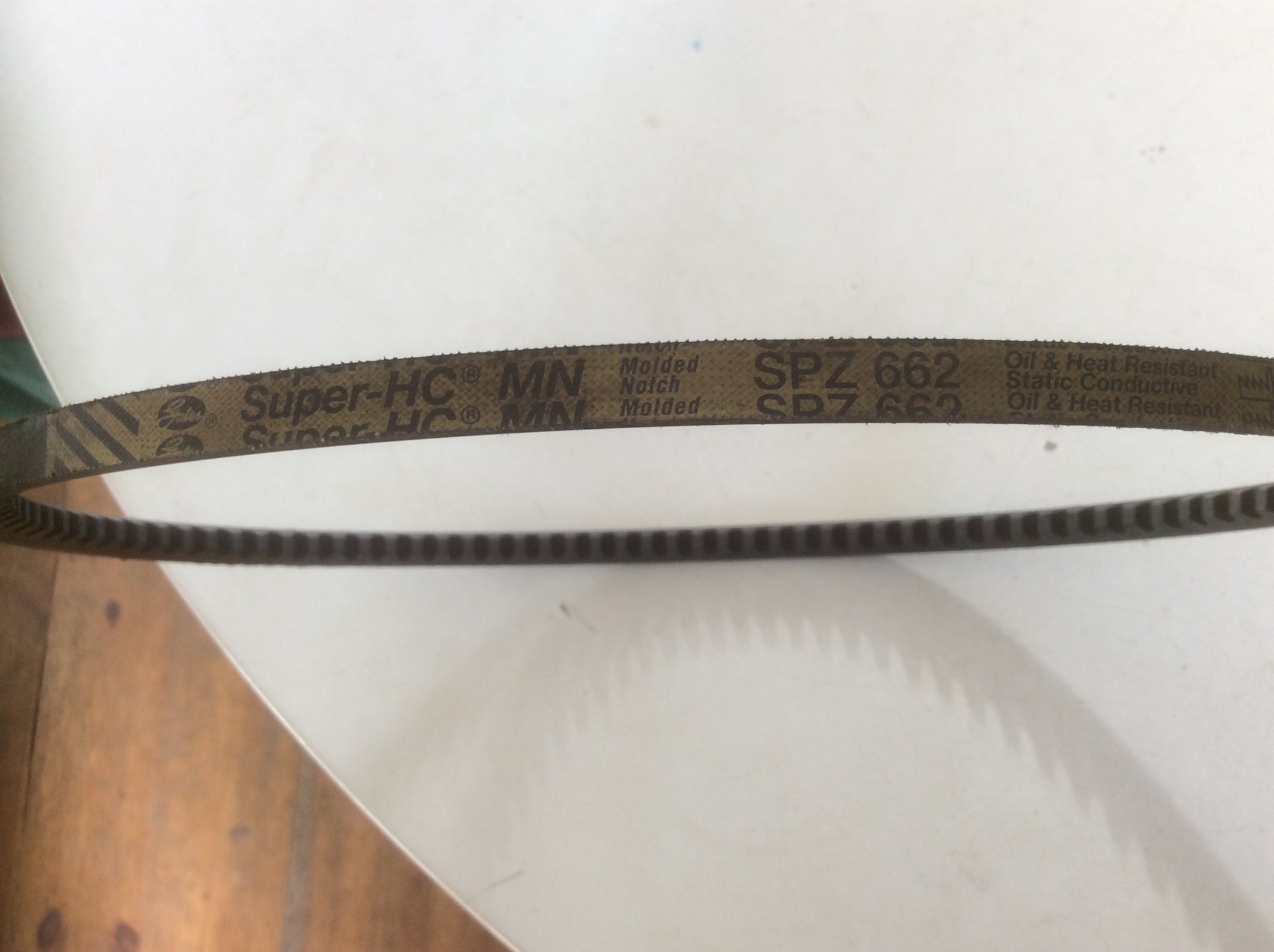

Have an Alpine A-13 bench drill sold by Graham Engineering of Birmingham (long gone) made it Taiwan

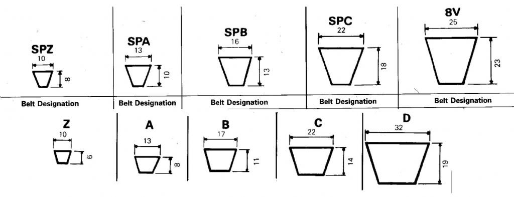

The 2 belts are showing their age one is an M32 Other is M33 the length is about correct but the form seems strange with is 9.5mm 375 Th, depth is 5.5mm 220Th these are aprox as belt is worn but not that much, this does not fit any form I can see
The M supposedly changed to a Z section or a 3VX may be any one with this drill like to have a look, it looks like an older Clark but their belts are same length don't know form
