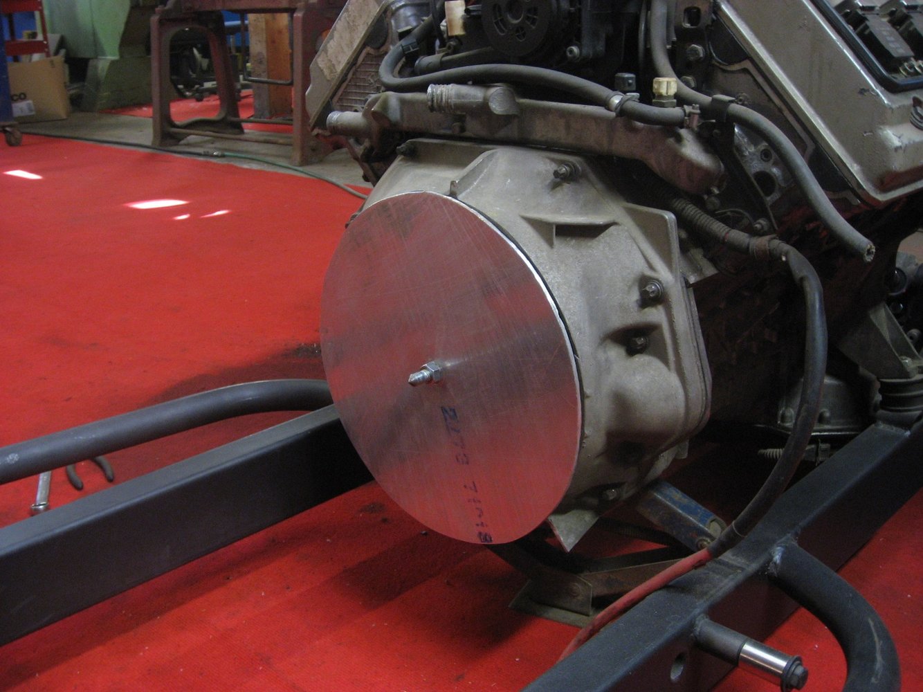

I am modifying a bell housing so will be welding a plate to it (5mm).

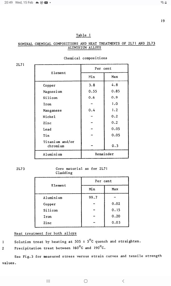

I have plate here that I got from a mate who worked at the airport (Loganair) It is marked Baco bs 2L 73..... hard to read but I am sure that is what it says.
Anyone shed any light on suitability? My Google game is poor....

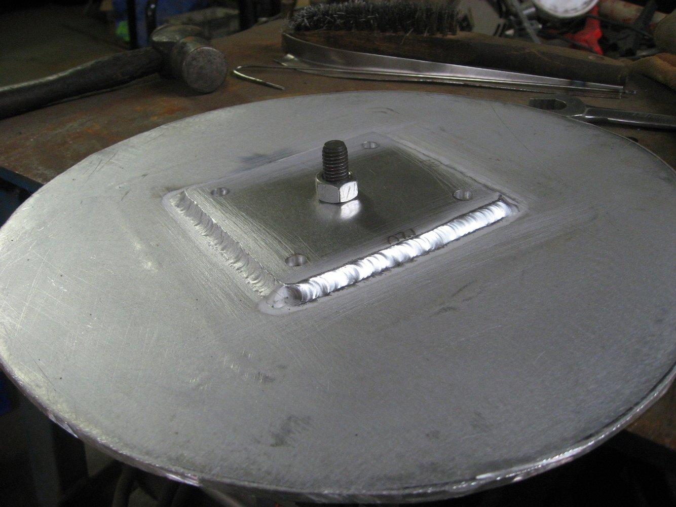

I tried this before years ago and tig'd a spreader plate in the middle of the circle and warped it massively so unuseable.
Not sure if this is the same sheet I used......
