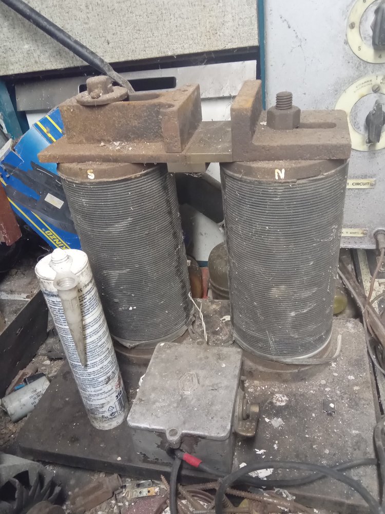

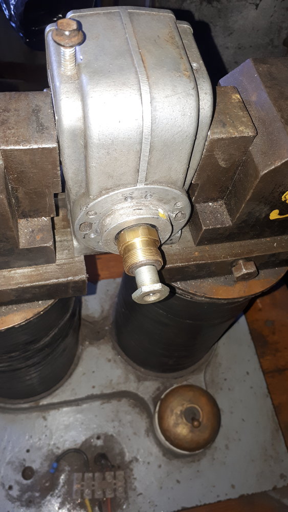

Mate’s tractor as above has a magneto that has lost magnetism. Anyone had experience of remagnetising or know someone who can advise?
Interesting info have posted to mate, is your machine mains driven @zeppelin builder I note the 3 core and old brass sw
Cant be AC unless there is rectifier somewhere
old enough to remember lead sheathed household cables and VIR
