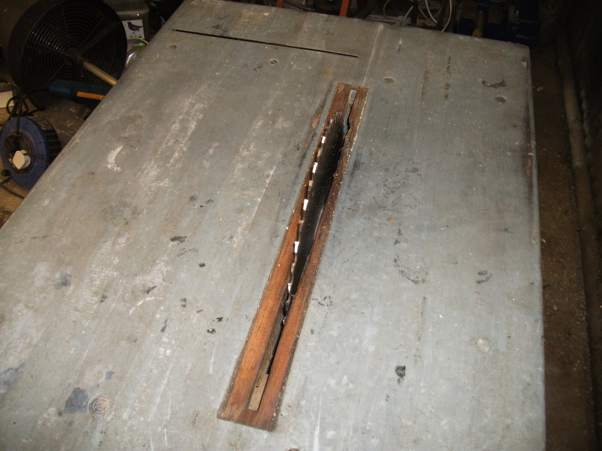

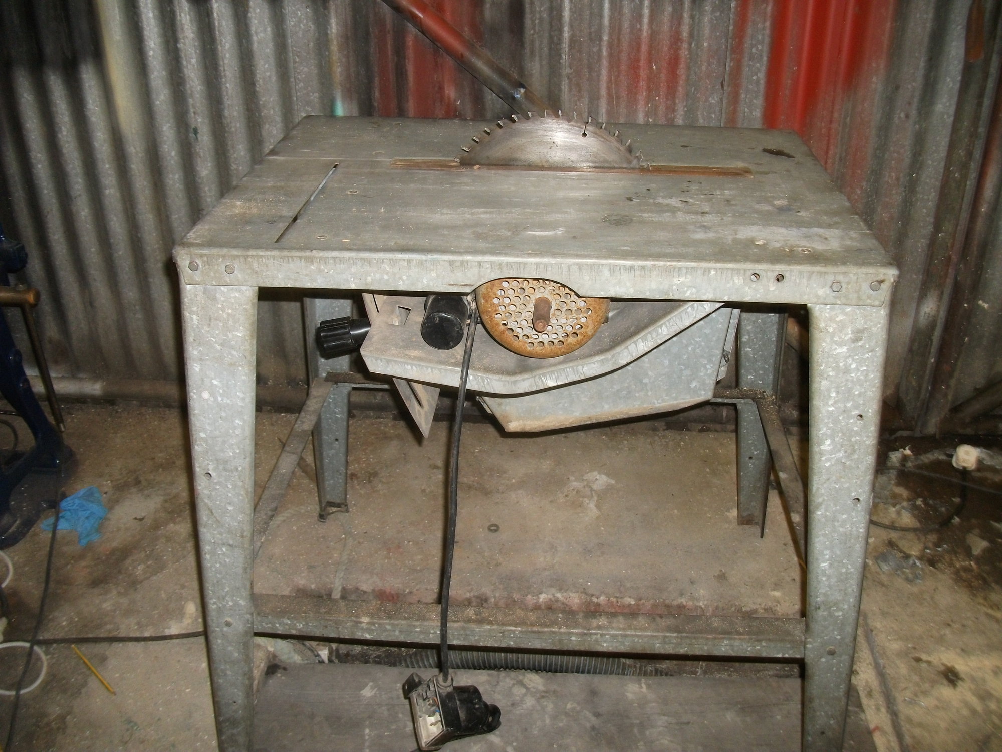

I got this saw about 35 years ago for 30 quid used it a fair bit and it packed in so has stood for 20 years .just dug it out and took the motor off it would run but hardly started up and not much power . took the capacitor off and got a new one of ebay 6 quid fitted it and it runs a treat .putit all back together and checked out for accuracy and it was a mile out shimmed under the motor and now its spot on
while the blade was off I touched the teeth up on the green stone on bench grinder it cuts like a gudun now. I even fitted a contact starter on it
