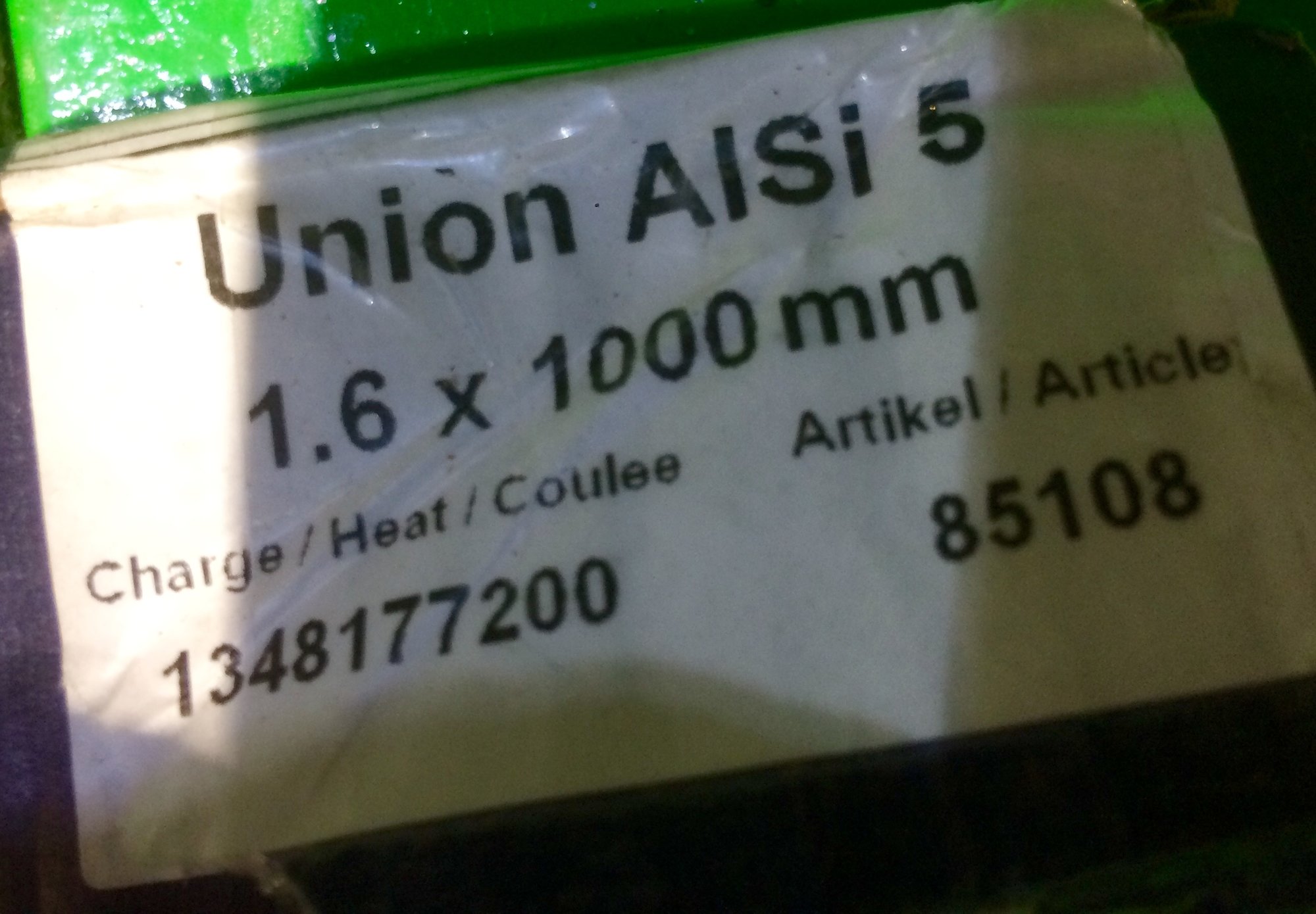

Oh I never knew that... so all the various grades of Aluminium are a mix of Ali and other metals to give it strength and ridgitity, yes.. otherwise Ali would be more like lead, eg too easy to bend etc with no real strength ..It's always an alloy, pure aluminium is uselessly weak.
1050 is pretty much pure.It's always an alloy, pure aluminium is uselessly weak.

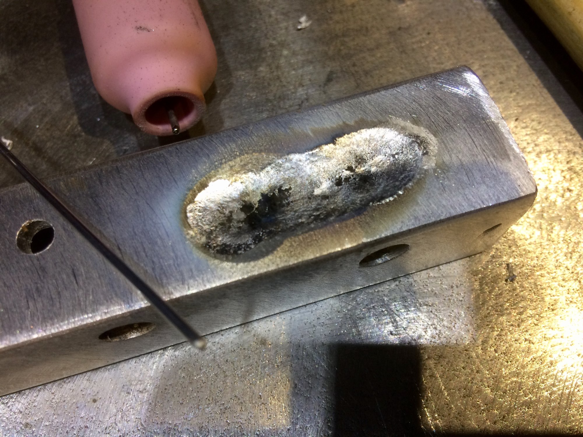

50mm x 150mm is a decent size. You could go 40mmx 150 but the smaller the coupon the hotter it gets

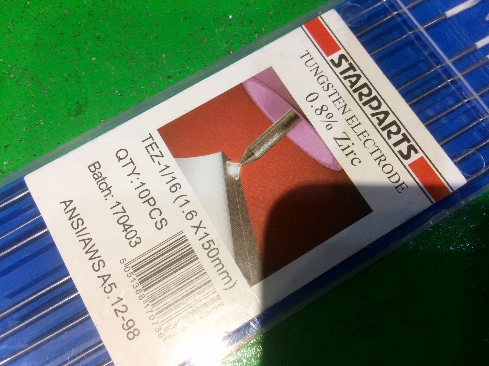

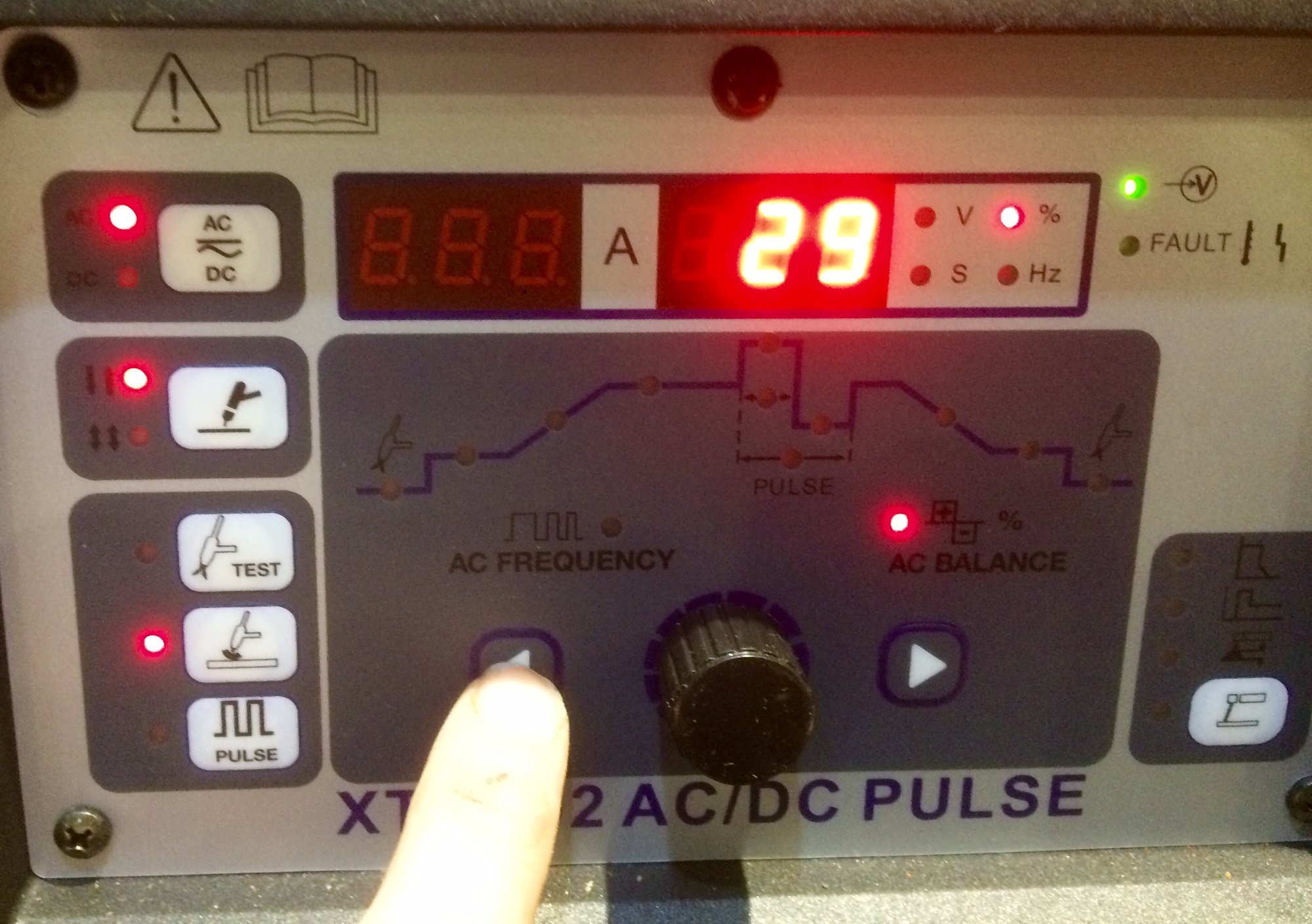

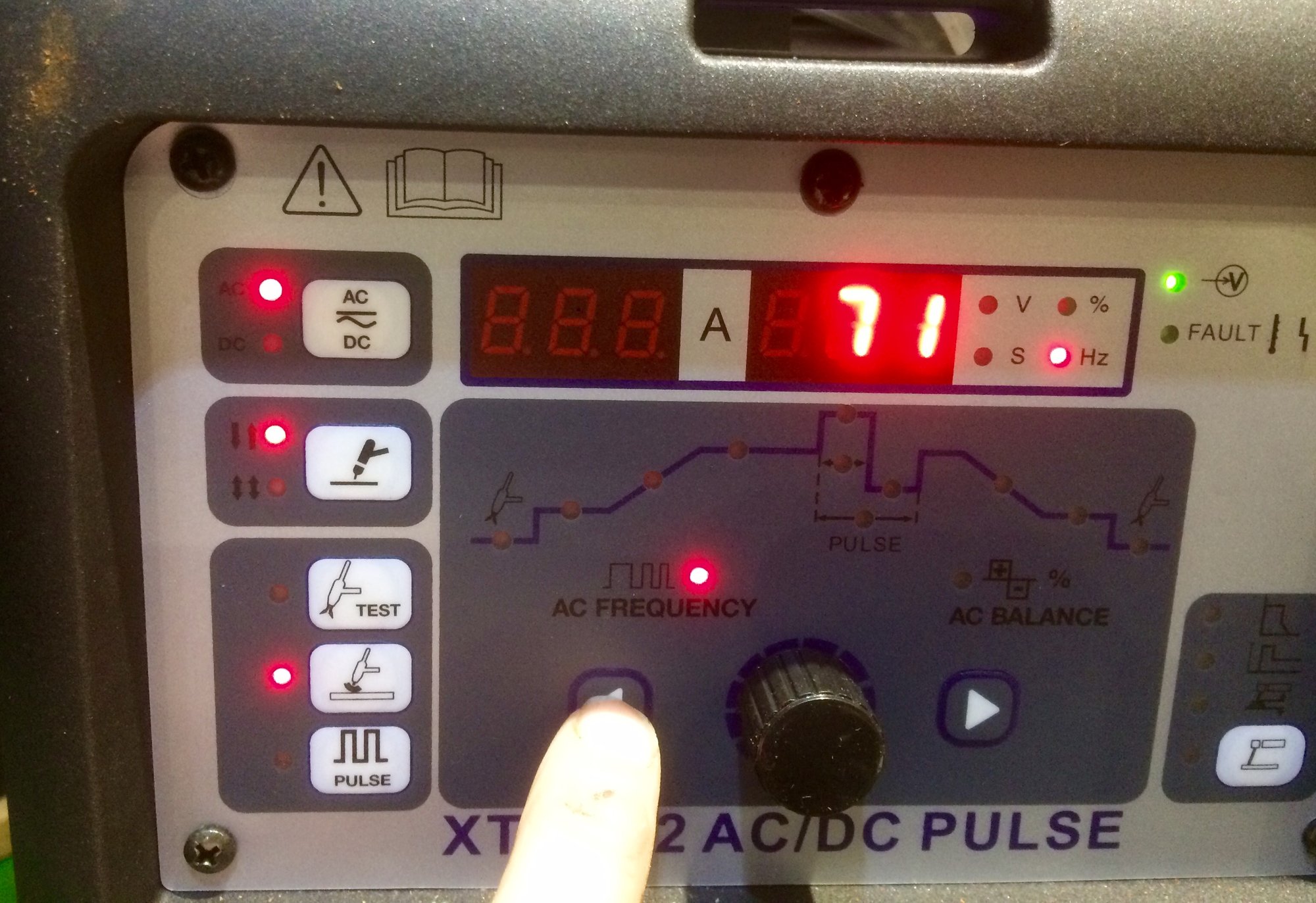

I haven't used this machine but does it let you set a slope when in scratch start mode?, what happens if you turn on HF. (I presume that's what the icons represent)Followed the basic instructions with earth lead in the + etc but, I've the foot pedal connected and when I try to set up the parameters it basically won't let me adjust what I should be able too.. it skips past the slope up and down and also the initialstarting amp stages which the book says I should set?
Yes mte I've holiday in Oct so I will book up via the travel agents.. one ticket to Sè Rechard I think that's in Cambs or Herts.. xYour simply too hot noods for the size of your piece. You know where I am if you fancy a morning getting the thing singing like a bird.
