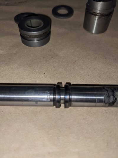

You could use copper sulphate based layout fluid - that would plate copper onto steel but no effect on chrome.
Wet a tissue with vinegar or weak acid and cover the shaft for a while. If it was steel the part will be etched where as chrome is generally resistant.

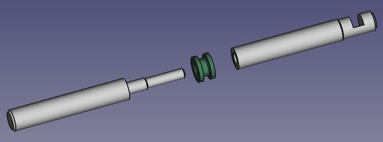

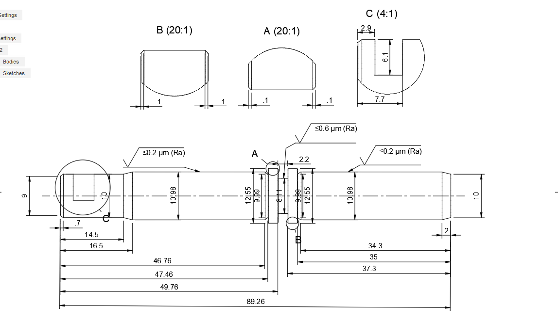

Turning is quicker, if I had both machines I'd likely turn the part leaving the seal surfaces slightly oversized. Harden and temper, then chuck up in grinder to get the final size.
Exactly the same if I did it in lathe except instead of grinding, I would simply be polishing starting at 80 grit upto 1000 grit until its as smooth as a babys bum. I do t have one but a toolpost grinder could also be used. I dont think you could tell the difference without fancy measuring equipement.
One thing Im unsure of with grinding, is what grit wheel a shaft grinder would normally use, do they swap a coarse and fine wheel for roughing and finishing?
For the hardening process I suggest the slotted end probably will be a weak point either sould be unhardened or highly tempered due to the sharp corners.
If you file test the original, is that end and the middle section hard?
