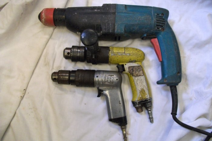

heres a few airdrills and an electric drill. the electric ones large and combersome but verry portable ideal for sitework and the odd use in workshop . if u have a compressor u can use air drills.there a lot smaller with the same amount of power . ideal if u have a fair amount of holes to drill the beuty of them are they dont snatch and snap twist drills. one of the drills is fitted with a silencer so theres no noise issues there relatively cheap to buy as well
