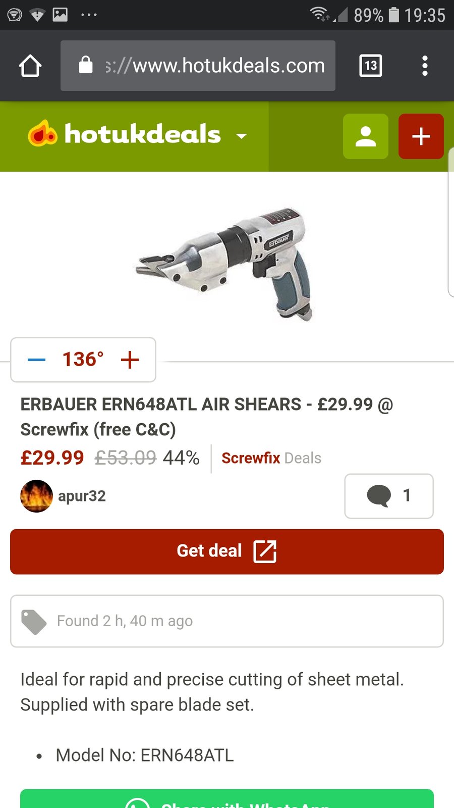

Had one from Aldi which looks similar. They are not like scissor (tin snip) cutting, more like a nibbler that takes about a 3mm strip out. Handy tool though.
