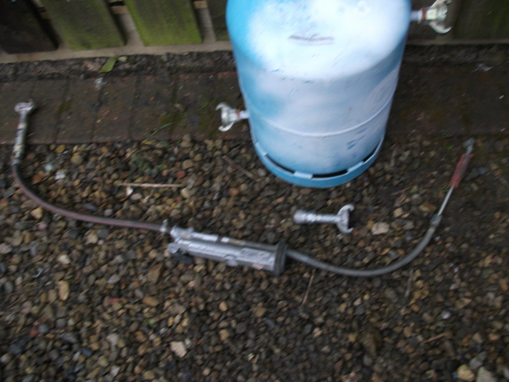

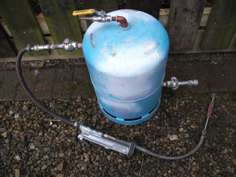

Yep, more questions from me i'm afraid
For those that have built air receivers. Did you weld in a pre-made 1/4" female nipple of some sort (if so, what are they called please?) or weld in some pipe which you tapped to the 1/4 thread?
Also, what sort of fittings do people use? I was thinking of a t piece, both valved with quick release for input/output. A separate pressure gauge and separate release valve.
Sound ok?
Sound ok?
err test a callor gas bottle after its been converted
ok . no need for an extra safty valve or a pressure gauge as u allready have them on your compressor .the tanks will equalise
