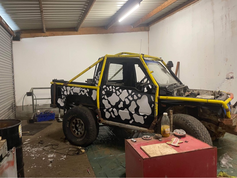

. I was going with a 10L minimum, purely of guess work. Race is half hour long but definitely don’t want to be running out half way through
When we did demolition derbies the tank used to be tin gallon cans strapped across the back seat panel, with outlet and vents soldered in...Years back I used to do the spannering for a mate who raced bangers.
We used old fire extinguishers in pretty much the manner you describe. They got banned in the end I think.
One thing I could see with your design being an issue is the sight glass. It’s a weak point which will allow a leak in an accident.
With the bangers we were limited to a quantity of fuel. No where near 50l. Which is why a cut off fire extinguisher worked well.
