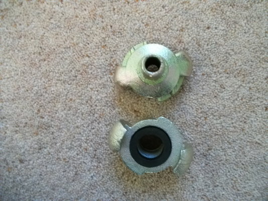

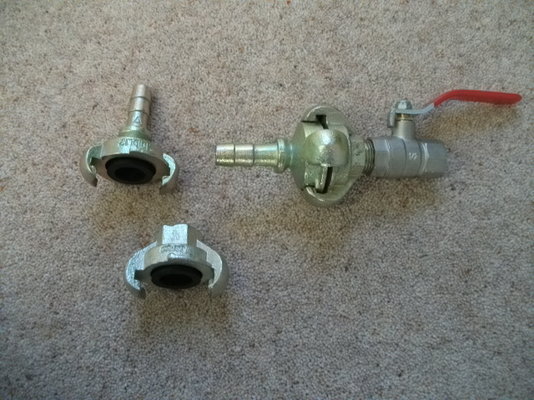

right i'm just in the process of trying to get together all the connectors needed to plumb up my pipework for the comrpessor. I'm planning on using some 3/4" gas pipe with various take off points.
however i'm going round in circles in my mind as to what sizes of connector a fittings to use
saliant points of the setup are
tank has a 1/2" outlet
this will be connected to air filter/moisture trap which accepts 1/2" connections
this will be connectoed to 3/4" gas pipe
this has 1/2" PCL couplings at various point
however i was planning on basically having a short whip lead from tank to filter with a PCL quick realse coupling on incase i need to move the compressor for any reason however i keep thinking all the 1/2" & 3/4" size stuff downstream of that PCL connector is really all unecessary as having such a small opening as on one of the PCL connectors i would imaging is the biggest bottleneck
i worring about nothing and its not going to make a blind bit of difference or should i sack off the PCL quickconnector between tank and filter and keep 1/2" and 3/4" airways all the way up to the PCL takeoff dotted around.(but again i guess the size of those again awill be the limiting factor so does it realy matter it theres one further upstream?
Hope these ramblings kind make sense, if not i'll try cobbling together a diagram
