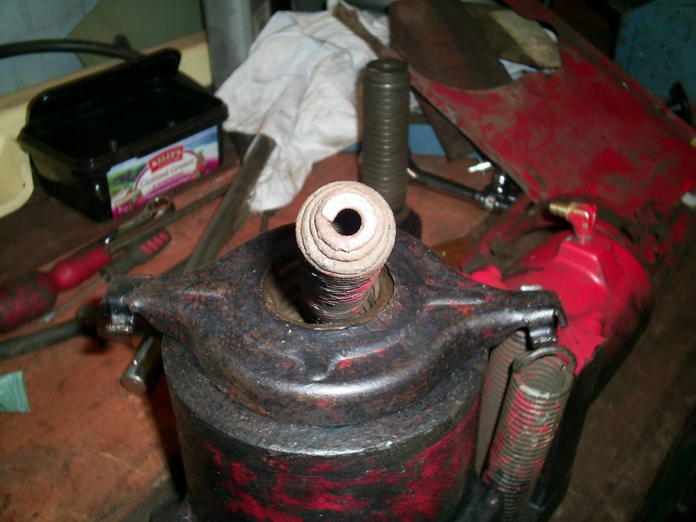

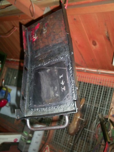

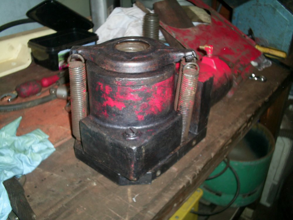

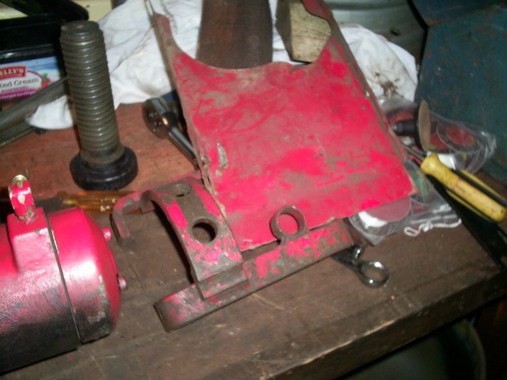

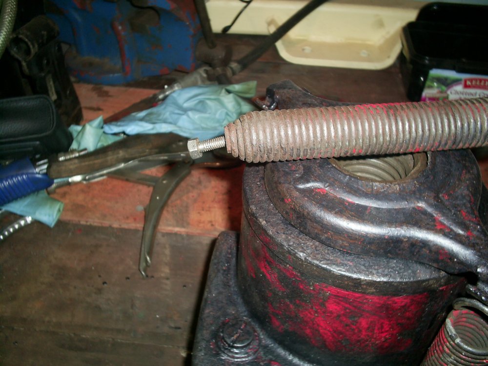

I decided to strip and clean this air/hyd jack I picked up at auction a bit back. I used it to lift the camper van for a bit of an inspection and boy did it make that easy. It works all right but was a bit bashed and scraped. Upon strip down I found one of the four springs that retract that actuator had broken and the previous owner had done a "fix" to keep her working. It must have had a hard life in a builders yard or on site as there was sand and grit in all the nooks and crannies. The bottom truck plate had a big circular hole in it where the jack reacted so that had to be cut out and new metal inserted. Luckily the main jack unit just needs a good paint and repaint. The side panels and top cover have taken the beatings.

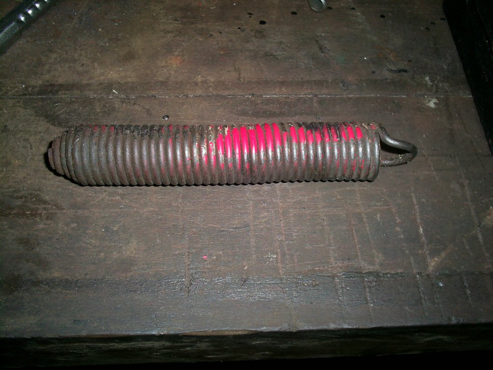

Anyway I need your help in tracking down a replacement spring. I have been on the website www.entexstocksprings.co.uk but they only advertise bog standard tension springs with a loop connection each end. As you can see from the photos my spring is held in place at the base with a nut and countersunk screw. The size is in imperial 6 ins long, 1 inch coil dia and 1/8in wire diameter.
Heres hoping somebody can steer me in the right direction.
Cheers Michael T
