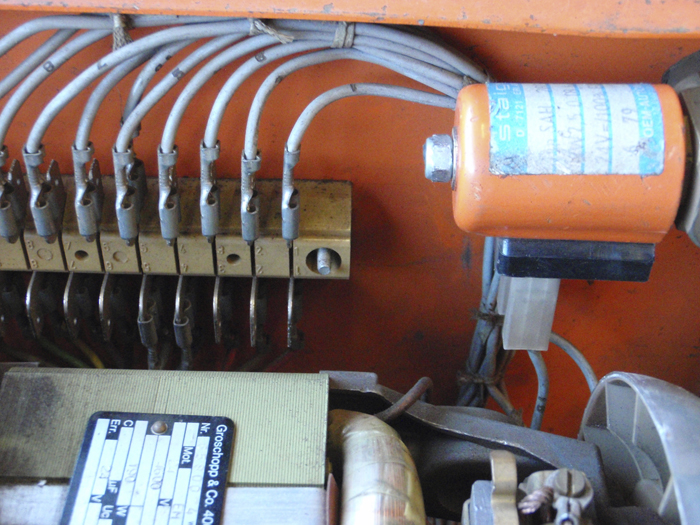

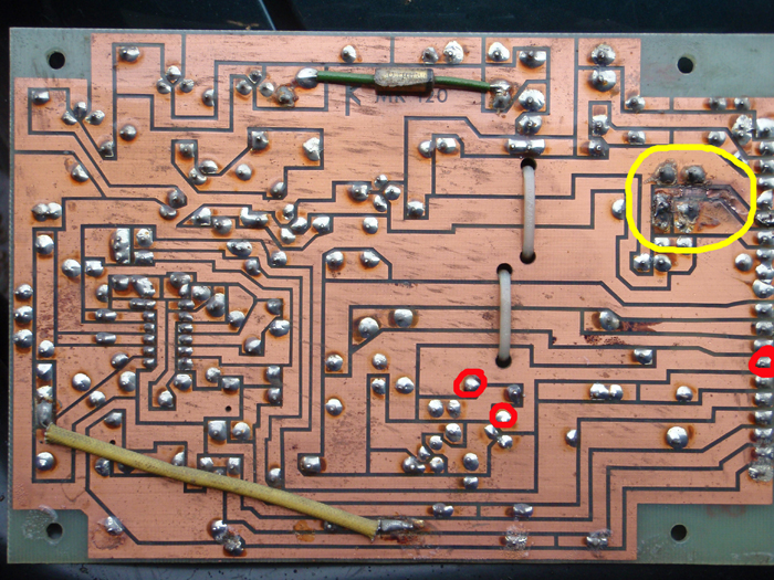

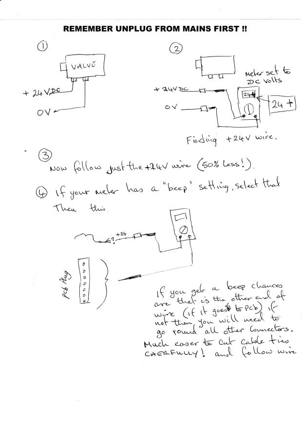

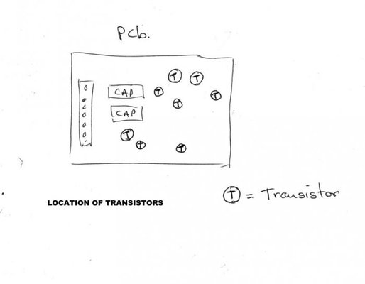

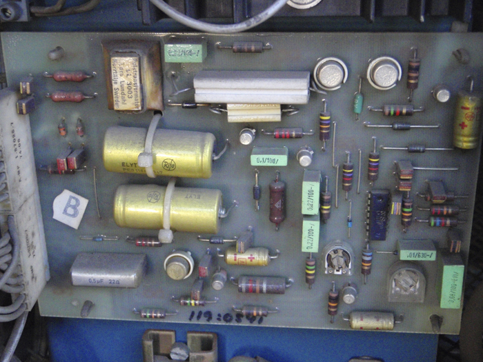

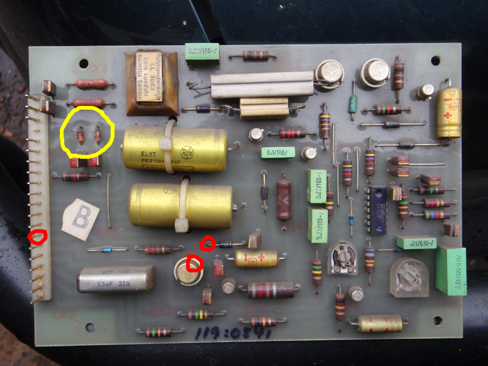

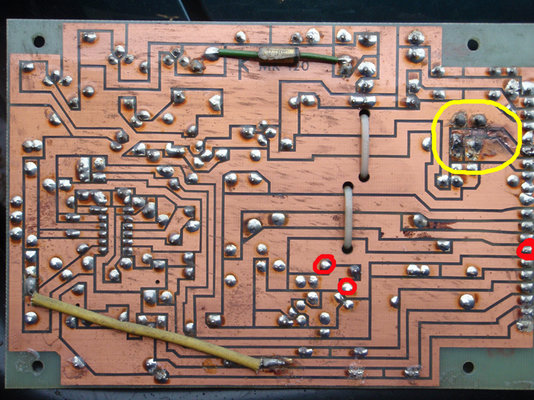

Hi guys, I'm new here but need some help. My AGA 300 mig has developed a problem where the gas runs immediately the power is switched on. I have taken the magnetic coil off the solenoid and powered it up and it is working, well it holds a screwdriver! I have the main cover off but can't see any relay or contactor that isn't pulling over when I pull the trigger. I'm at a bit of a loss. Could the coil have it's own control built in?
