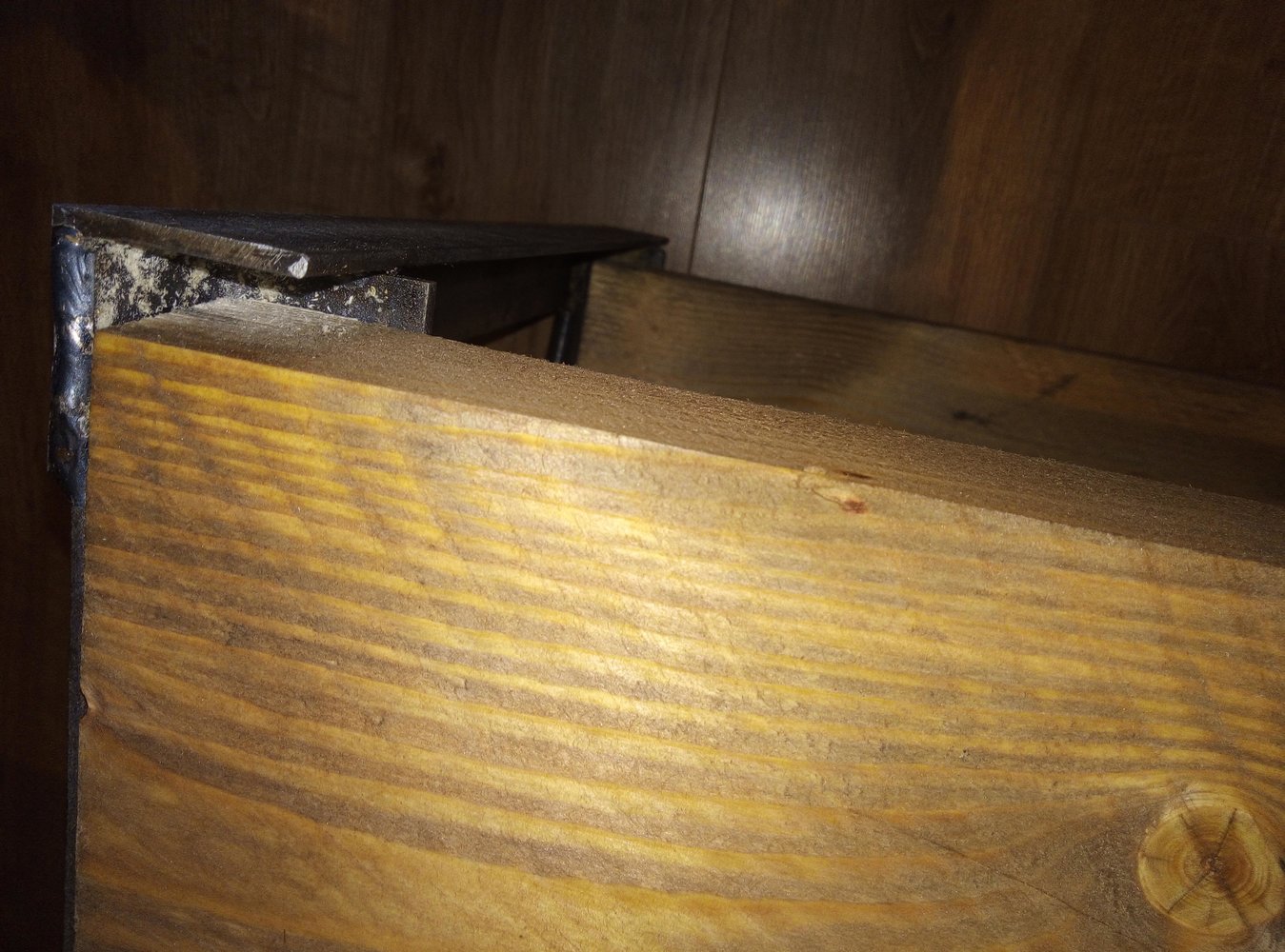

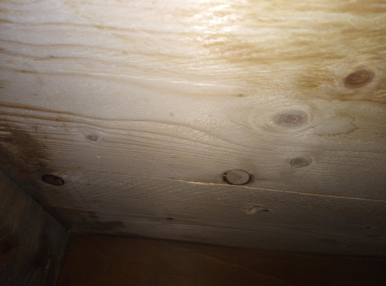

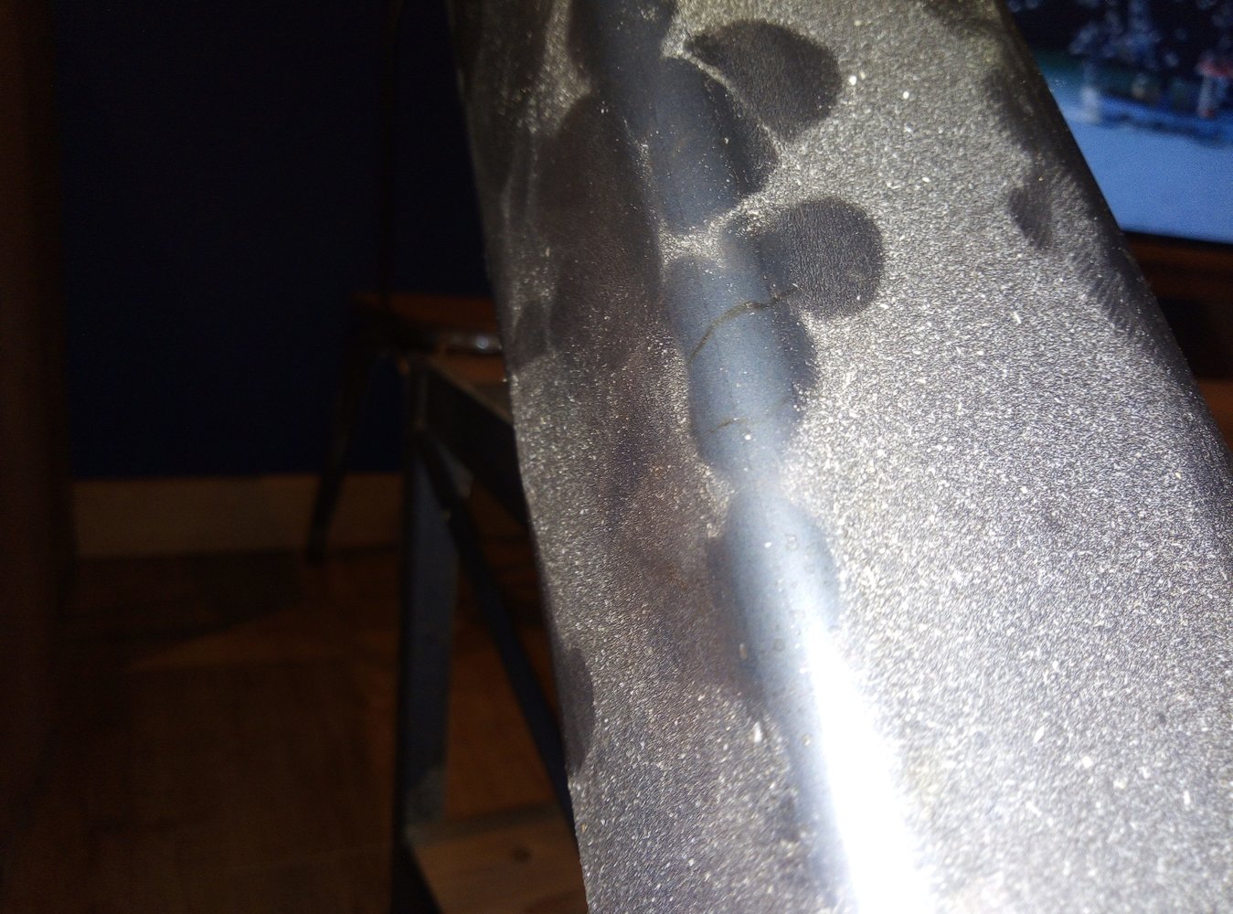

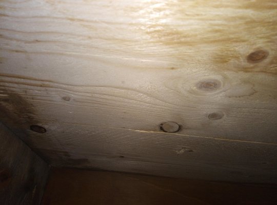

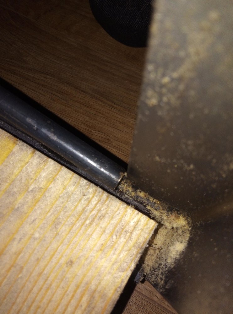

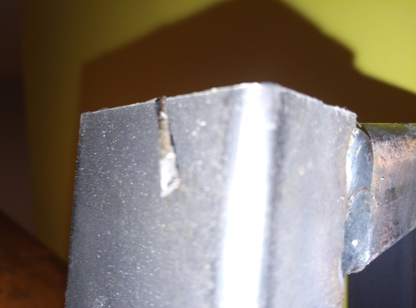

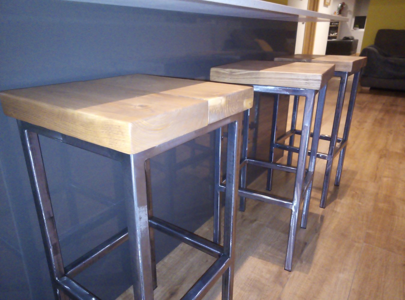

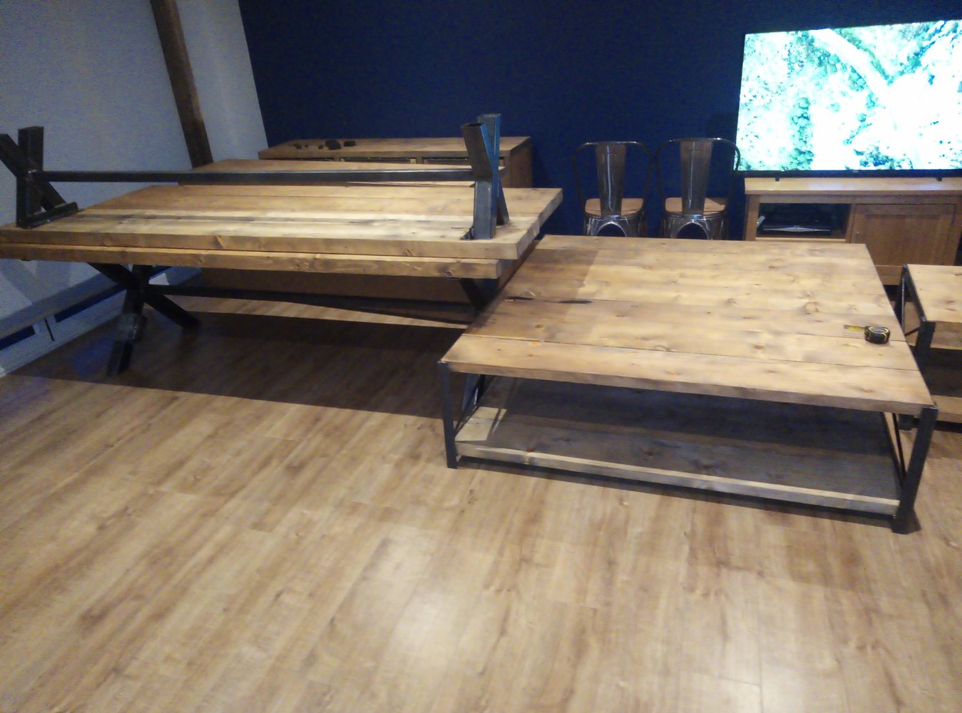

The Mrs ordered some furniture on the internet back in January, The style she wanted is something I could of done, but as always im time poor so she went ahead and oredered some off a couple of firms that looked like they did a half sensible job, The first turned up a month or so ago, a lad on his own and IMHO made a fairly nice job.......... Then on Friday this lot of Garbage rolled up, This is just some of the low lights.

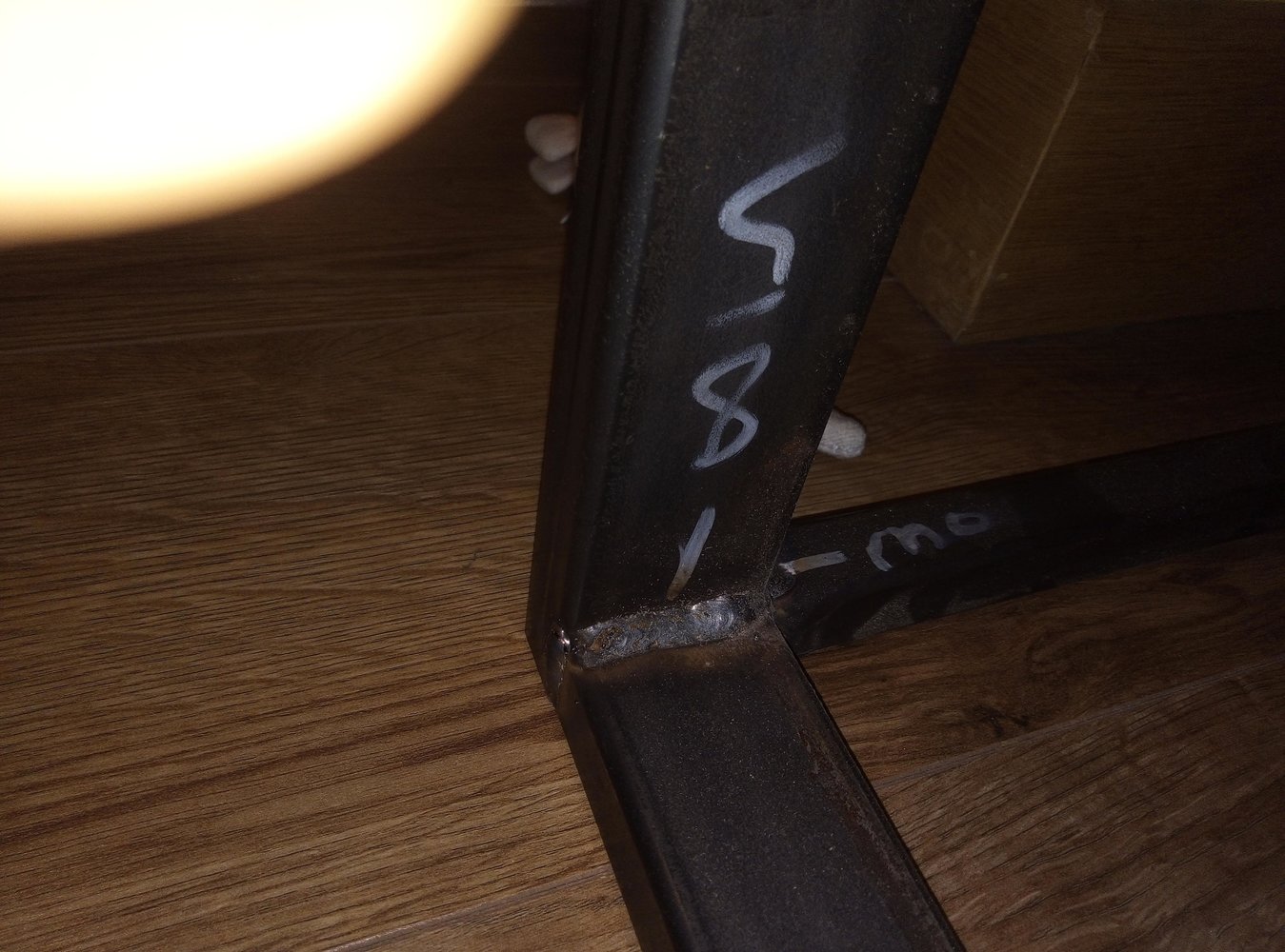

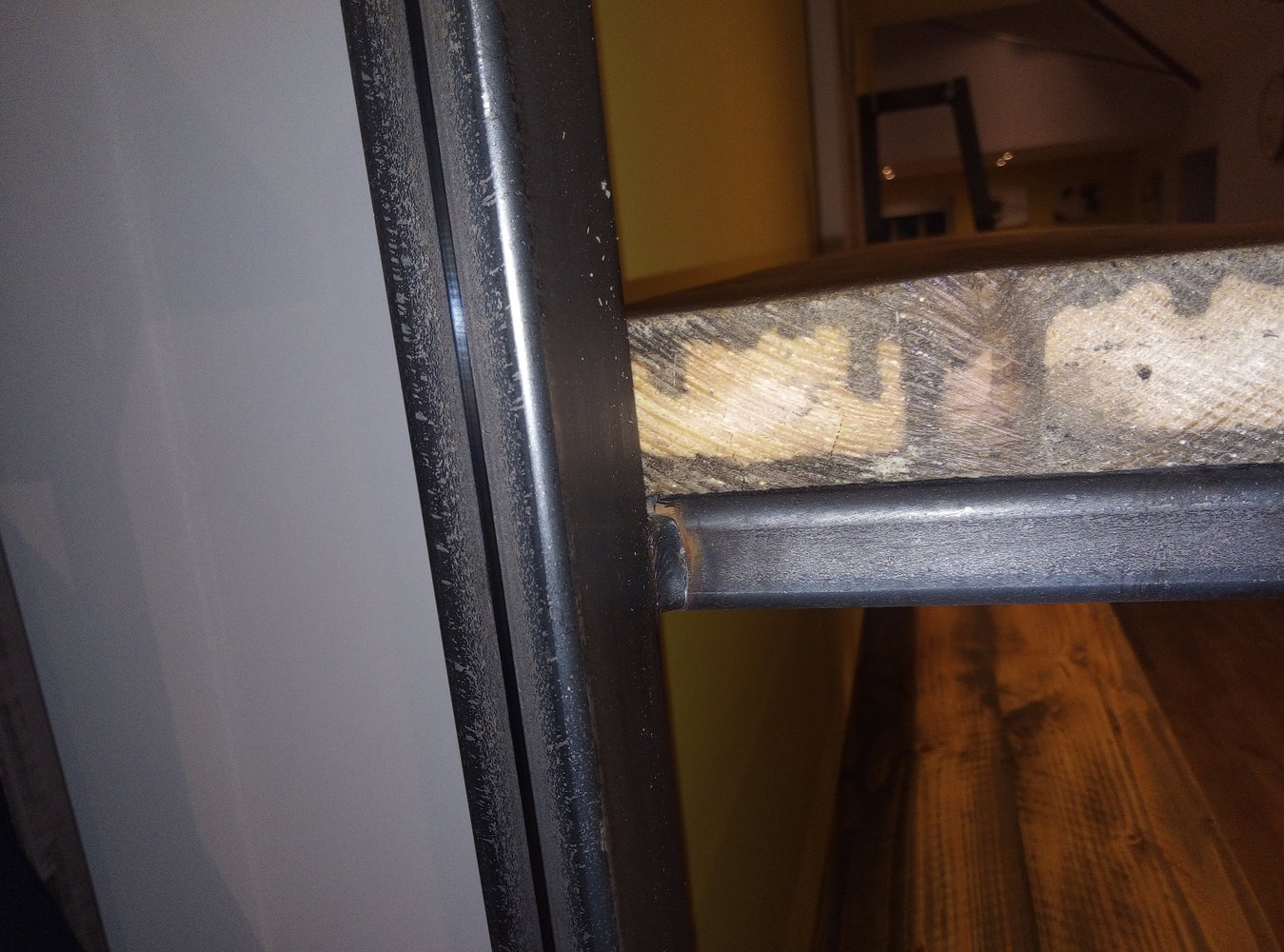

Nothing debured straight out the saw razor sharp, compounded by the fact they havent even bothered with a wax so the whole lot will flash over with rust as soon as it sees damp.

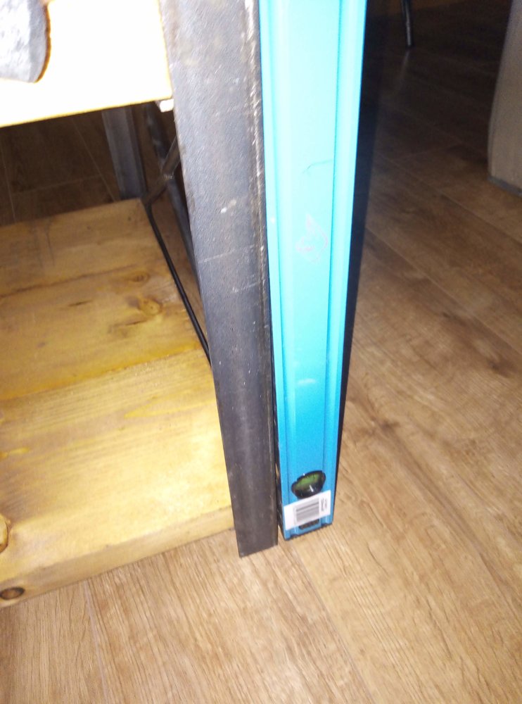

Nothing fitted properly, whole lot had linsead oil thrown at it whilst still covered in dust, and after it was put in the metal.
Backs are all viable and only held on by a handful of screws so there all gaped.
everything filthy and covered in poxy oil.
Nothing is treated underside and has more pitch than a cricket field.

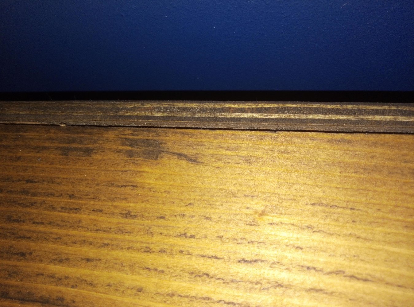

Ends of the timber havent seen a sander and left for the oil to just run its way in.
Paint Id marks from the stockholder even left in place.

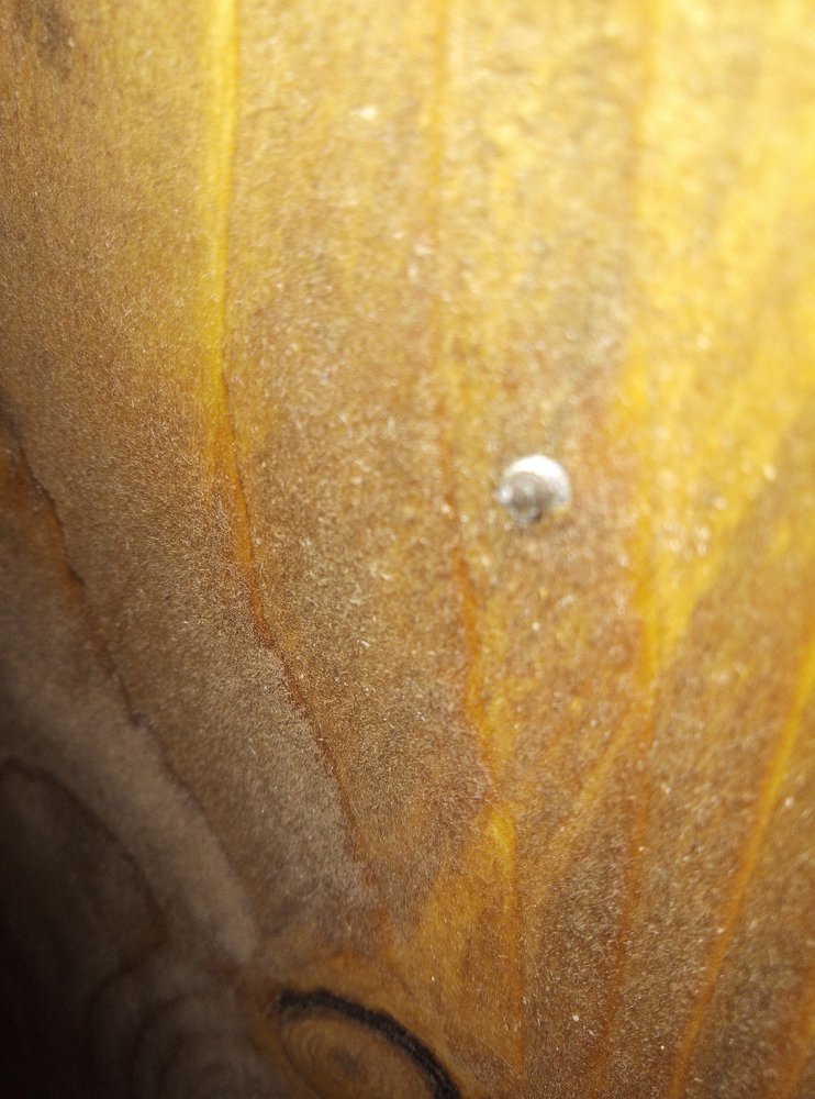

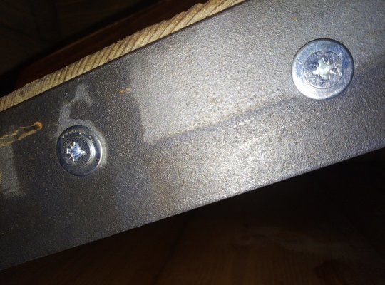

My favorite zinc washers with poxy screws instead of CSK on everything not even centered, or evenly spaced.
Screws used too long that poke through the side.
More...........
