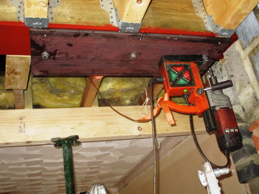

The Job:
Rotabroach (Times two) qty of 27 X 18 Ø holes in 12mm x 300mm mild steel plate. Position Horizontal down
Rotabroach (Times two) qty of 27 X 12 Ø holes in 12mm x 300mm mild steel plate. Position Horizontal overhead
(Times two) qty 20 of through drill 6.8 Ø holes and tap of M8 x 1.25 in 8 x 40 Mild steel flat 2nd & plug only. Position Horizontal down.
(Times two) qty 12 of through drill 8.5 Ø holes and tap M10 x 1.50 in 10 x 30 Mild steel flat 2nd & plug only. Position Horizontal down.
(Times two) qty 10 of through drill 10.2 Ø holes and tap M12 x 1.75 in 12 x 50 mild steel flat using 2nd & plug only. Position Horizontal down.
(Times two) qty 5 of through drill 14 Ø holes and tap M16 X 2 in 15 x 100 mild steel flat using 1st , 2nd & plug. Position Horizontal down.

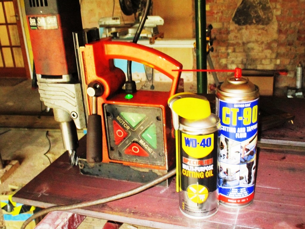

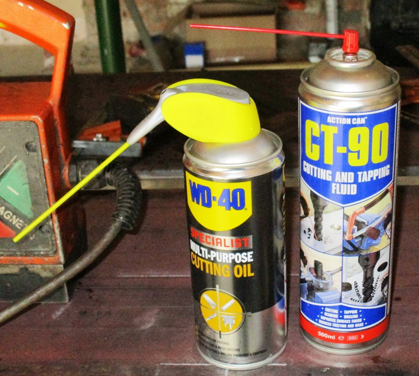

The Contenders;
Action Can CT-90 Cutting & Tapping Fluid 500ml @ £6.99 from Toolstation. Product code: 61138
Description: purple-blue coloured fluid, sticks well to steel even over head, slightly acrid smell, boils off quickly if forcing rotabroaching or drilling hard, best used little and often with moderate force for best cutting action. Sticks well to taps and allows easy cleaning of swarf.
WD-40 Specialist Multi-Purpose Cutting Oil 400ml @ £6.95 ToolStation Product code: 56345
Description straw-brown colour foaming fluid with a neutral sweet smell, flows easily and drips away especially when rotabroaching overhead causing a right mess. OK to use in downhill horizontal position but boils off quickly if forcing rotabroaching or drilling hard. Other jobs indicate it flows away too easily on angles and slopes.
Aerosol folding head gimmicky and not secure as it kept falling off or becoming detached when handling to spray overhead.
