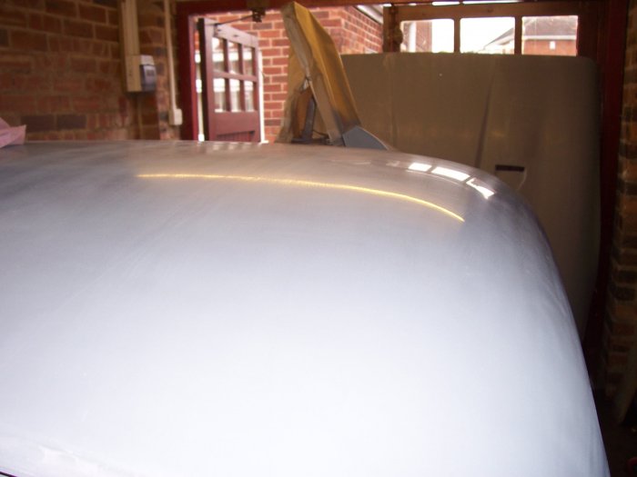

I've done several paint jobs using solid colours but this is the first time I will be spraying a Metallic. I will be spraying the same system 2K clear over base and I've wet sanded down to 800 grit the same way I do with solid colours. I have a few queries though do I have to change my technique of spraying in any way also for this project the doors will have to be sprayed off the car I have them mounted on stands and they would be sprayed at the same time but wondered if this would show up on the doors as a slightly different shade?.
The other issue I might have is shown in the picture below although I have done several 800 grit wet sanding passes I still have some dark areas in the primer and although feels glass smooth if you look at them with a magnifying glass it a slightly rougher surface. With the solid finishes I've done before they were not a problem but will these show through in a metallic?
Thanks
